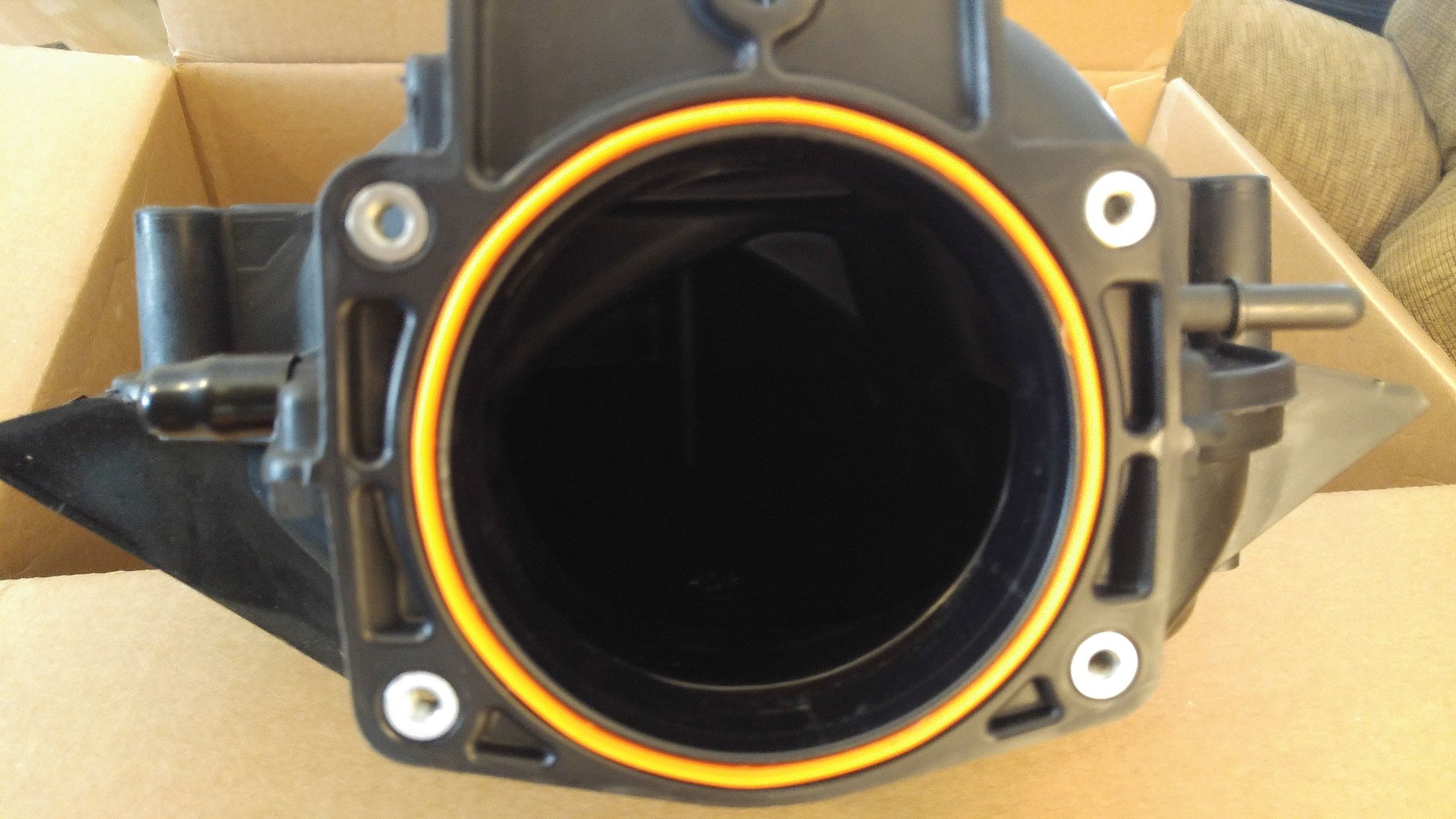

92mm snout

It is hard to tell in the pics, but does the snout allow for the use of both the three and four bolt throttle body??? If so, that would be awesome!

I think an adapter will be needed to put a 3 bolt tb on the intake. Will try to get a better picture.

I still think that this hole would allow for the use of a 3 hole TB. You might have to move the insert from one of the upper corners to use it properly.
