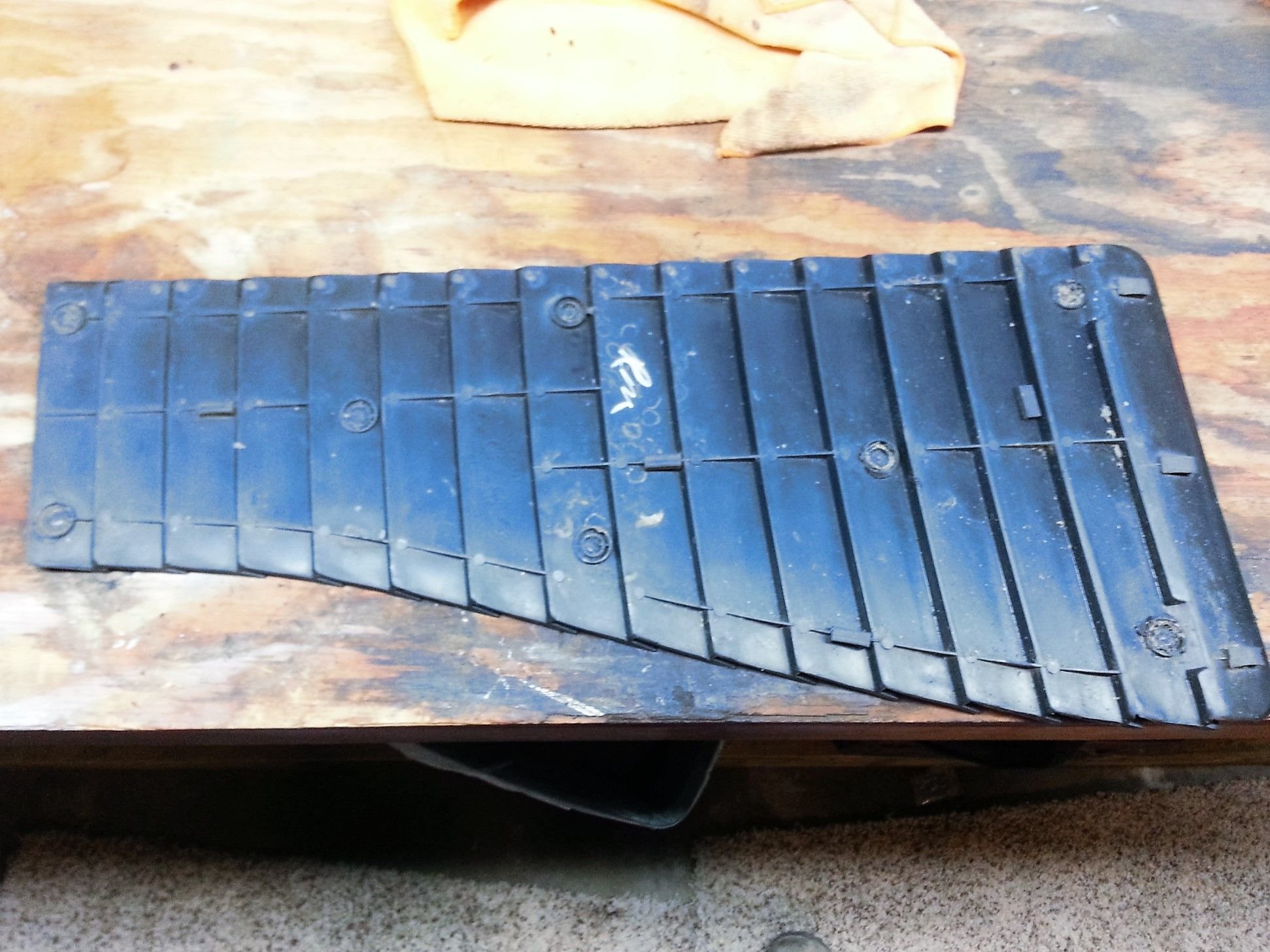

So I picked up an '87 IROC some time back and the majority of the studs on the hood louvers were busted off. I decided to replace the plastic studs with bolts and am hoping this will fix the problem for good.
So here is how I did it:
Started off by carefully breaking off the remaining studs with some needle nose pliers, and then using my die grinder with a carbide bit, I ground the remaining material down so it was flush.
Next I took sixteen 1/4"-20 x 1/2" round headed bolts and ground them flat with my angle grinder ,so they would sit flush in the holes. I also used some metric flat washers so that there would be more surface area for the epoxy to adhere to.
Next I mixed up the two part epoxy per the directions and added a good amount to each hole. Then all of the bolts with washers were added and I made sure all of the bolts were positioned real well.
I let both of the louvers dry undisturbed for a few days and then bolted them to the car using some rubber backed washers and 1/4"-20 nuts. You want to make sure you don't over tighten them or you run the risk of breaking the epoxy loose. Also once I get the car painted I'm going to use some loctite on them to make sure they don't back off.
So that's pretty much it and I hope this gives you an idea of how easy this is to fix. I spent right at $15 for all of the hardware and epoxy which is a heck of a lot cheaper than $300+ for new louvers lol!

old post, but would you happen to have the pics?
I've got an idea what and how you did it...
How did it hold up?
How did it hold up?

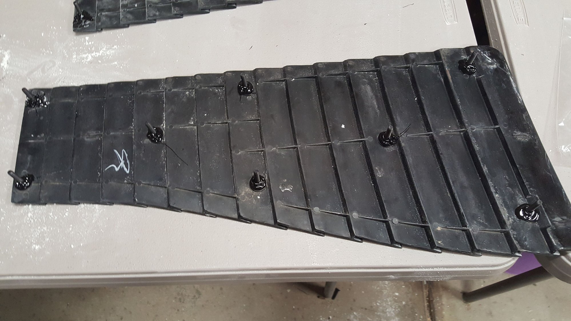

Ok, this is what I did...
First broke the remaining of the studs...
Ok, this
Flatten them out with a Dremel...
This is how it looks with the glue and the bolts...
This is what I used...
Ok, this
