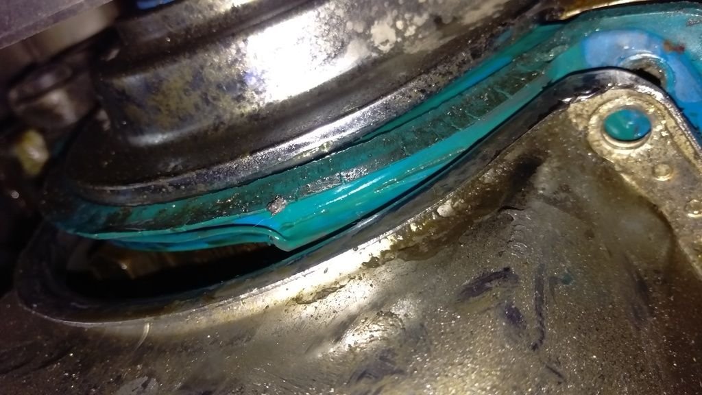

Well, I believe I found the cause of my leaking oil pan. I don't think I'll ever be using second-hand oil pan gaskets again. The one I used was sitting on a motor that was never fired up, so it was assumed to be good. It wasn't. I have another couple of projects in the works for the Camaro, and I'll be sure and update for each one. Oh, and to those wondering, you DO have to lift the engine up until the bellhousing touches the firewall to get the oil pan completely out.
