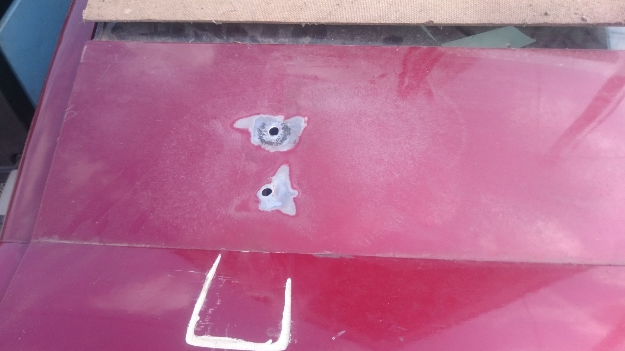

Since high school IIIrd gen T-top Camaro was the Car i wanted to have some day. In 2013 sept. i finally had oportunity to by the car. Now i try to restore it. it is slow build but i would like to have it in driving condition repainted for the next summer. Started this thread to have same help and advise from you guys.
Some pictures when i brougt it home.
paint is in very bad condition

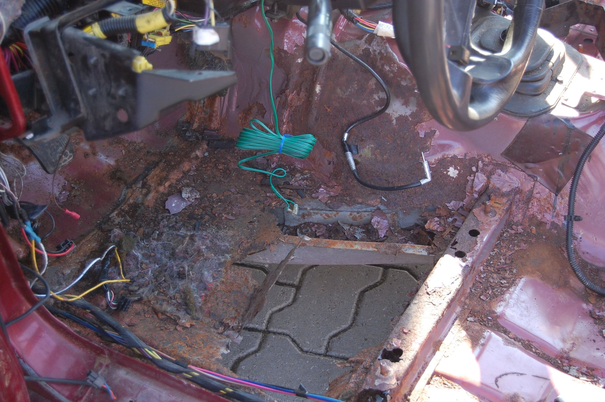

drivers side floor need to be restored.

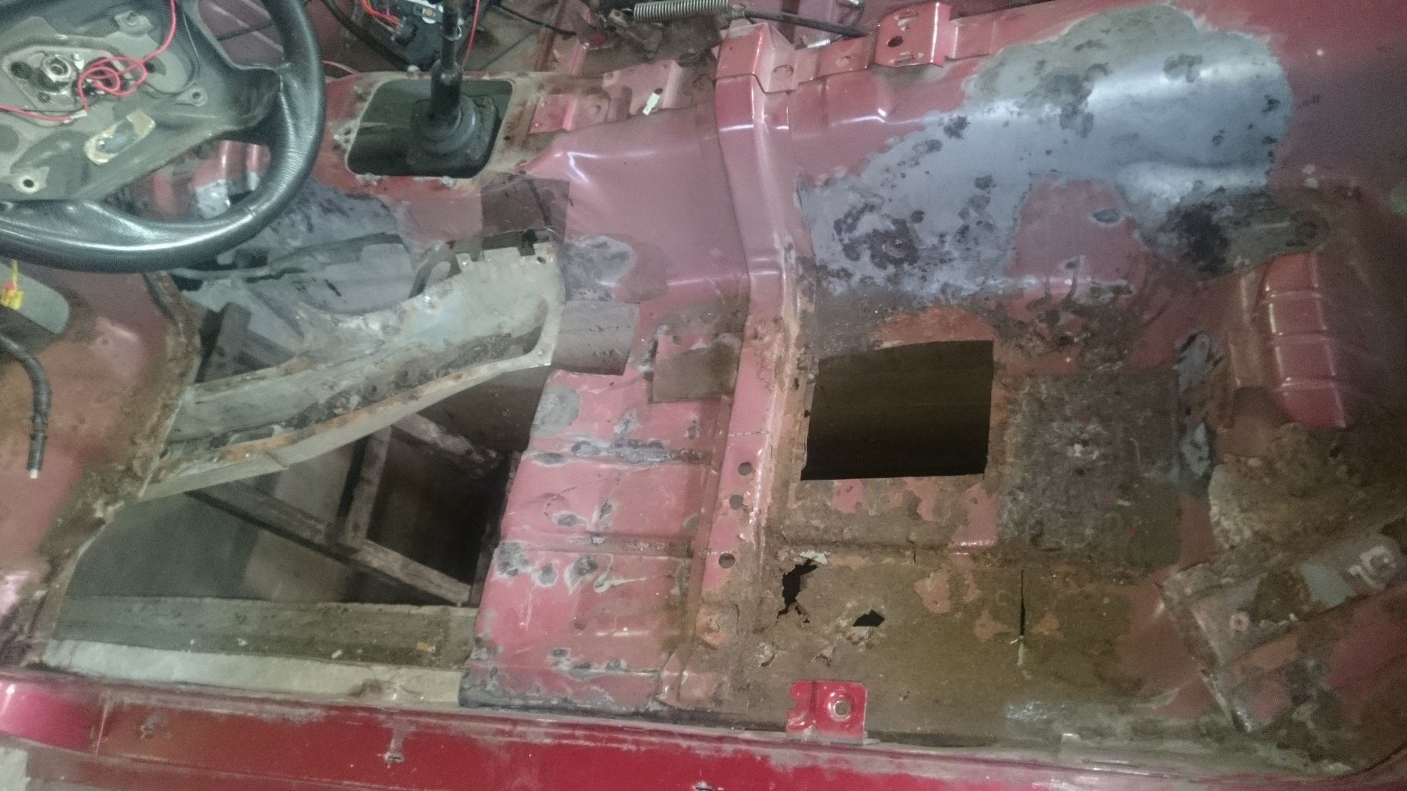

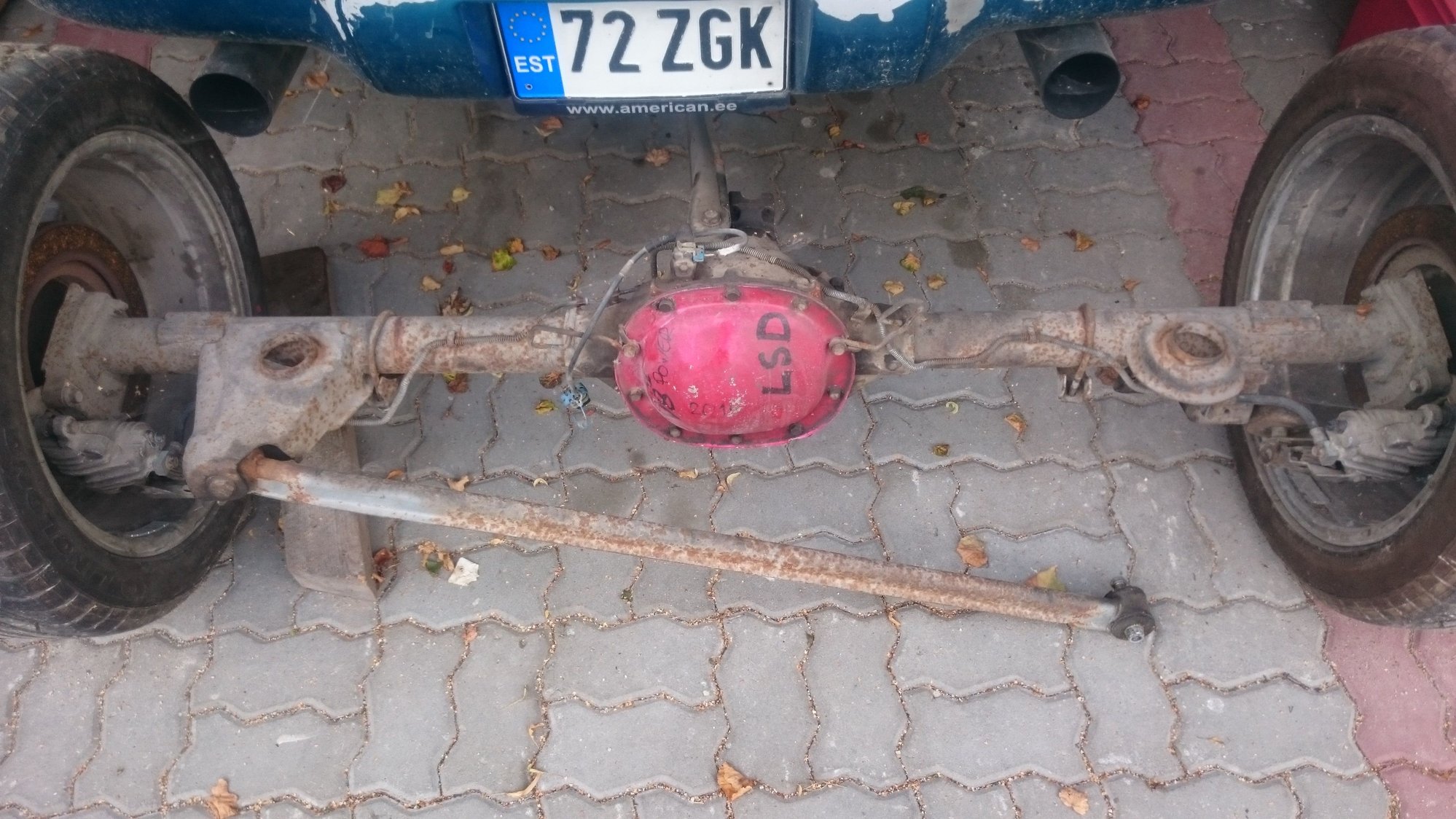

Little upgrade, not much progress but still. Drivers side floor pan repaired and new metal welded in. there were lot more rust i expected. Haven't had time to do all the work myself and hired person who knows how to do thing right in first time.
Also bought the Pontiac as a donor car. Runs well, bur rear differential needs adjustment because it is very noisy while driving. Also the moving from in firs gear was rough and i decided to unbolt the trans. Found badly grinded flywheel and clutch that must be replaced soon. started to look for new clutch kit and found this M-PACT 04134ST2. Has anyone experience with this kit or should by the cheapest one LUK or SACSH?

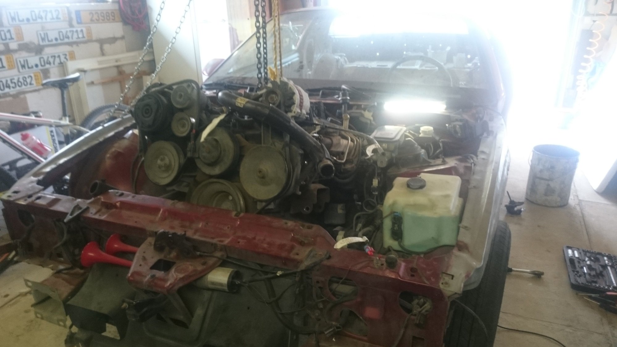

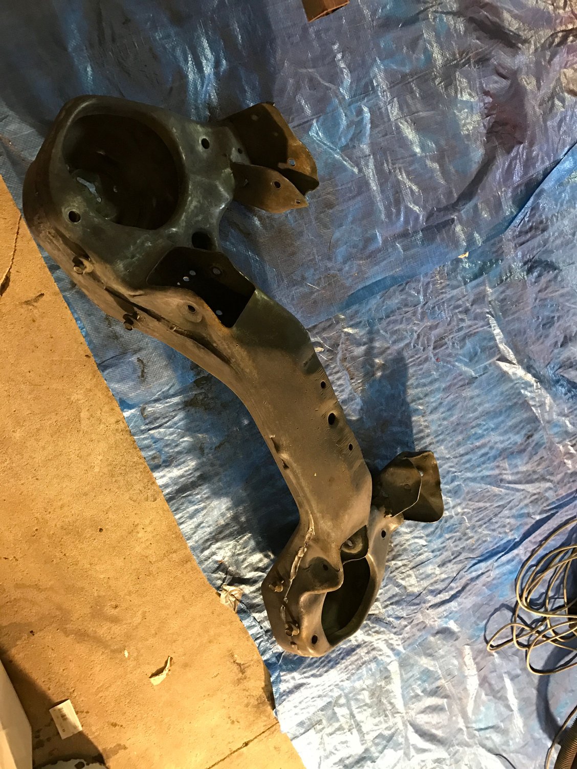

Not much of progress, but lt1 is in. Now i have to make a new support frame for t56. Before putting lt1 in i changed both crancshaft seal, oilpan seal, spark plugs. Will post pictures when i will be back from vacation. Im triping in Florida and hoping to visit at least one car gathering or show in orlando. Do you guys know or can suggest me any event from 13-17 januar in orlando or nearby?
Best

Custom made gearbox crossmemeb is done and installed. Yesterday arrived some new parts. Hope to find soon some time to install them.

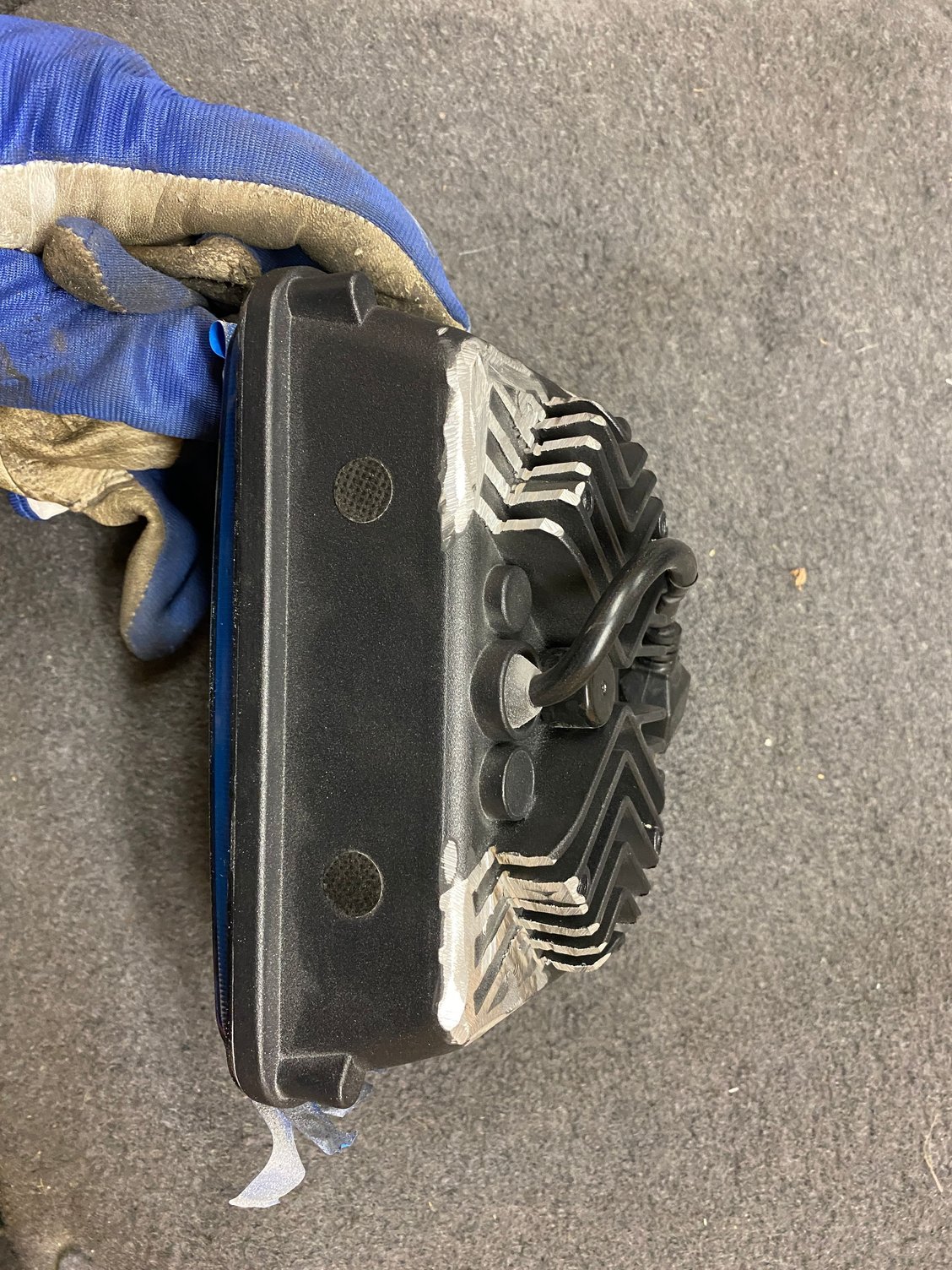

Does anyone know where does this part on the photo belongs? Can't fit it anywhere
Will post later some pictures of the progress.
Its been few years I haven't done anything on this progress, but now iam back and will try to finish build this year. LT1 is in and running. Now i need to fabricate custom exhaust put the car back together to send it for painting.

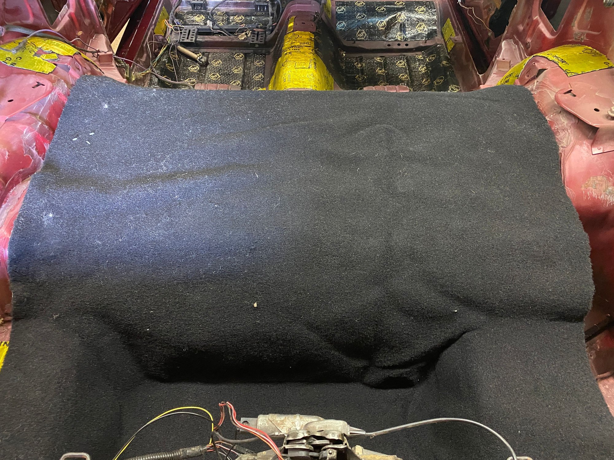

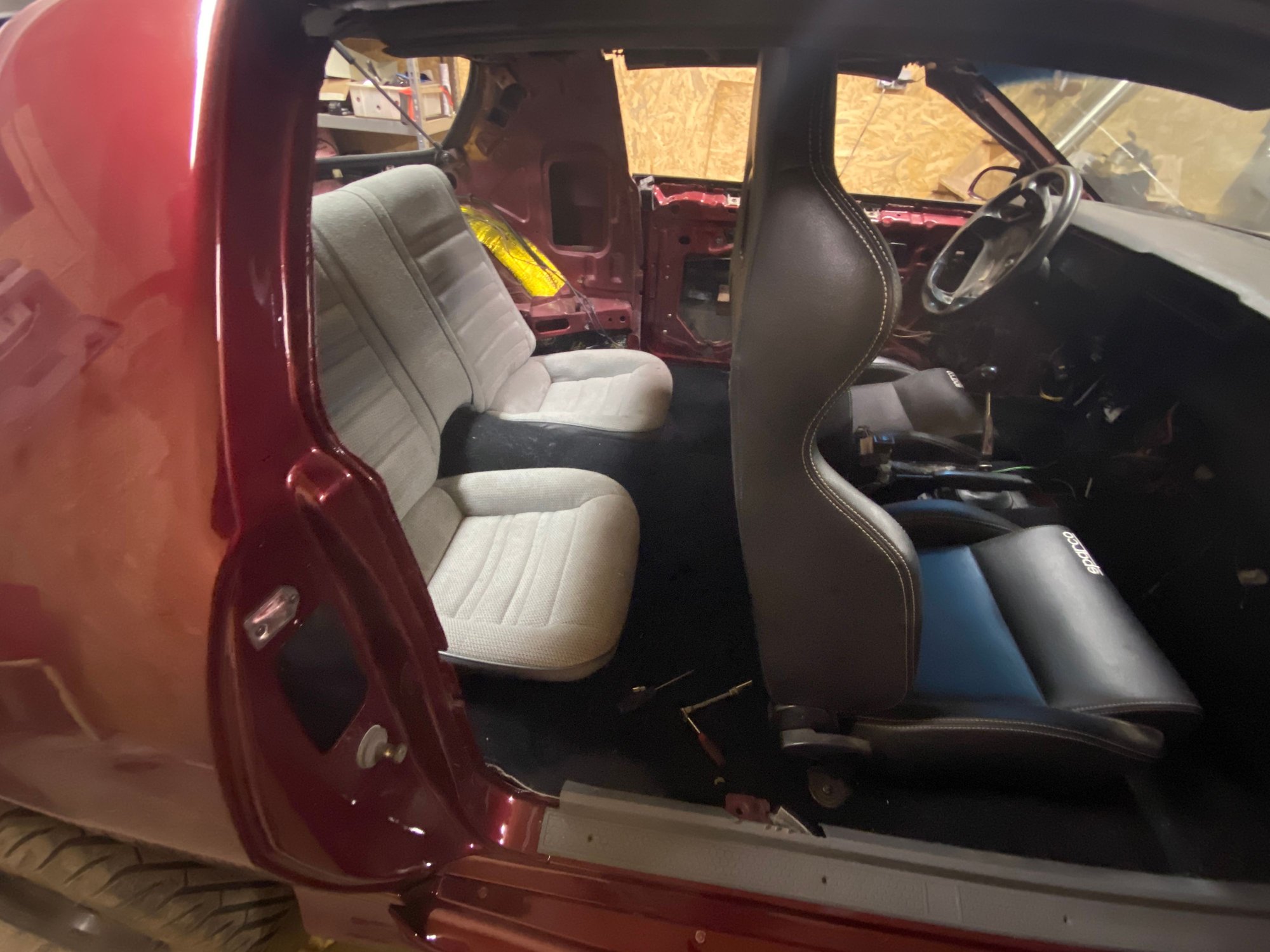

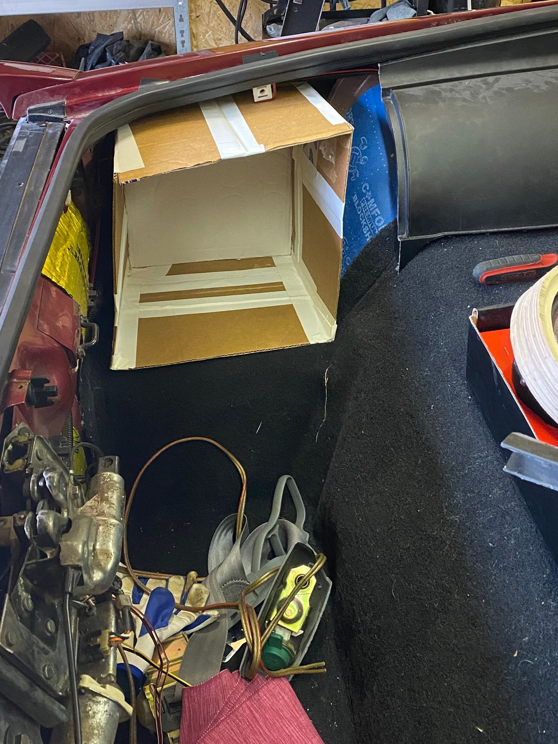

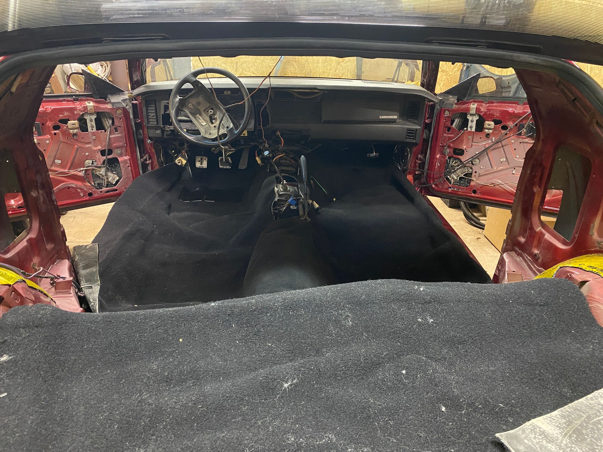

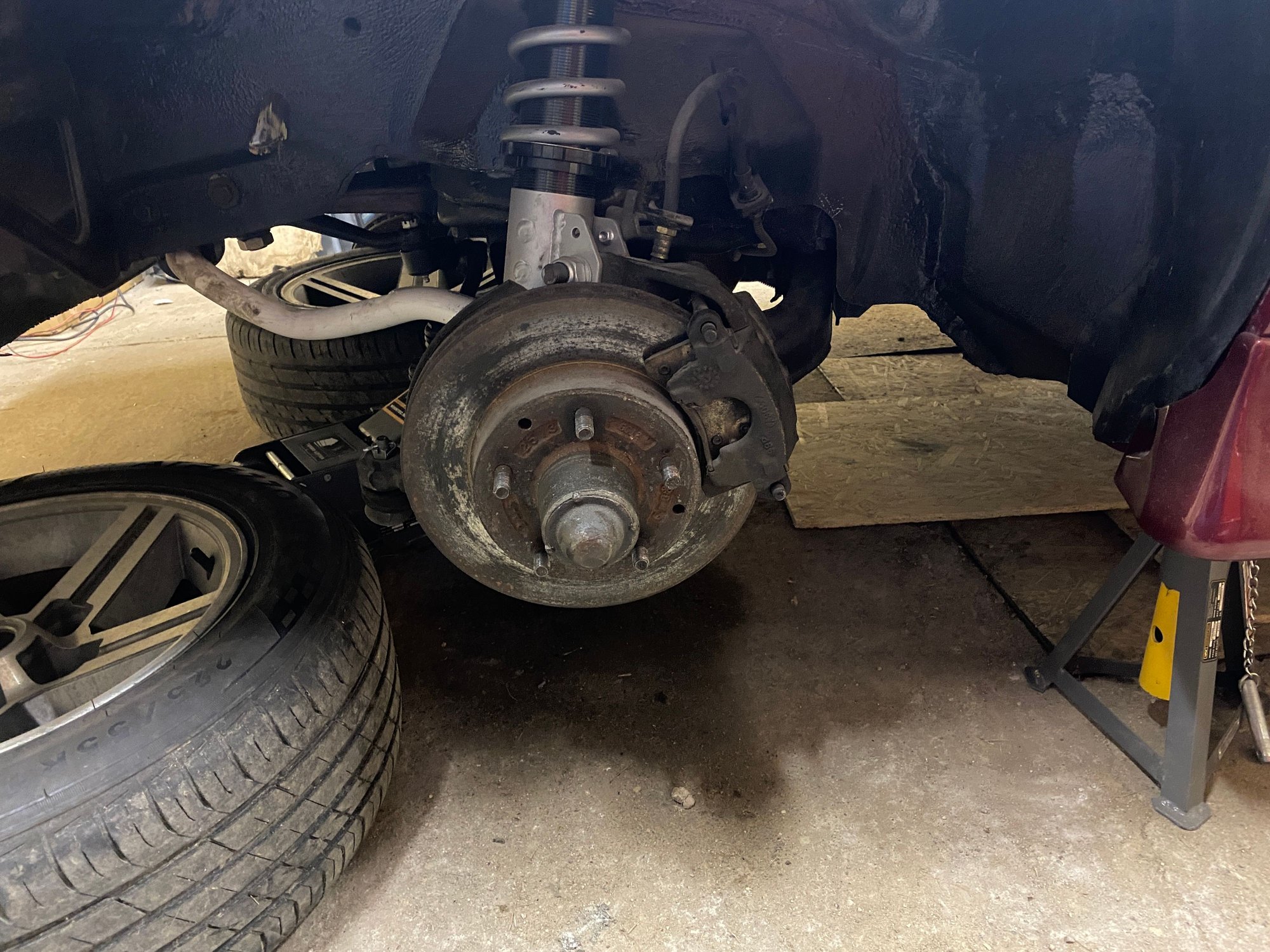

Some pictures of progress, not much, but will try to get it done. Too much time has past, don't remember disassembling and it's taking time now to assemble it all right. Today i tried to install dash, but failed. It's real pain. Engine harness is unfinished and is real mess at the moment. Haven't find good place for ECM. Thats why harness is unfinished.

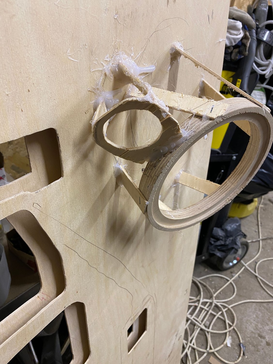

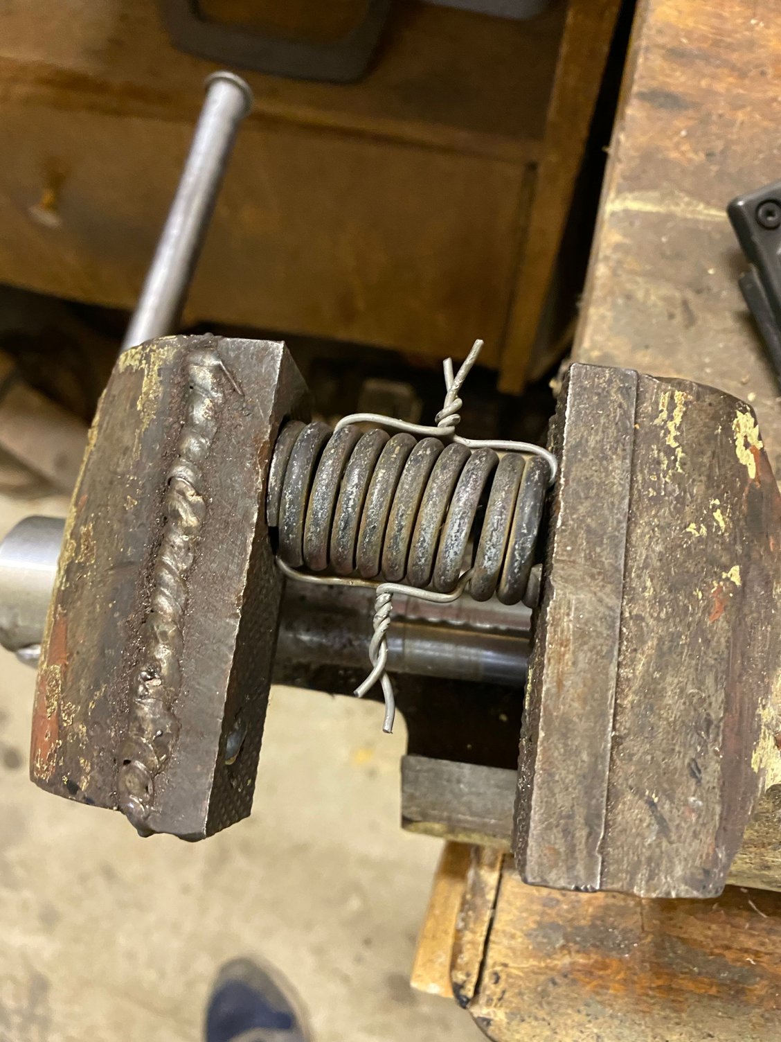

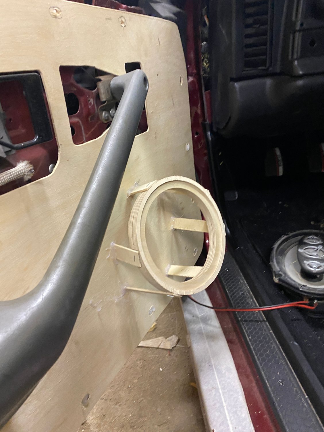

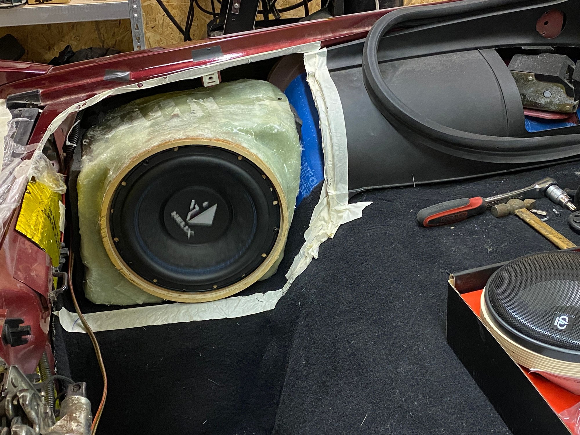

Little update: redid door hinges, even those that are not included in repair kit. Relocated ECM and had to repin and extend approximately 70 wires. It took a little time . Installed dashboard, that was real pain, i would like to say I will never do that again, but i know that it will be done real soon. Post some pictures, unfortunately forgot to take from todays progress. Also have one question about one plug that is under te dash near VATS. So pleas let me know if anyone knows where does it goes.

The plug that i cant find where to put it is on the 4th picture from the bottom with the purple wire. Does anyone know where does it goes?

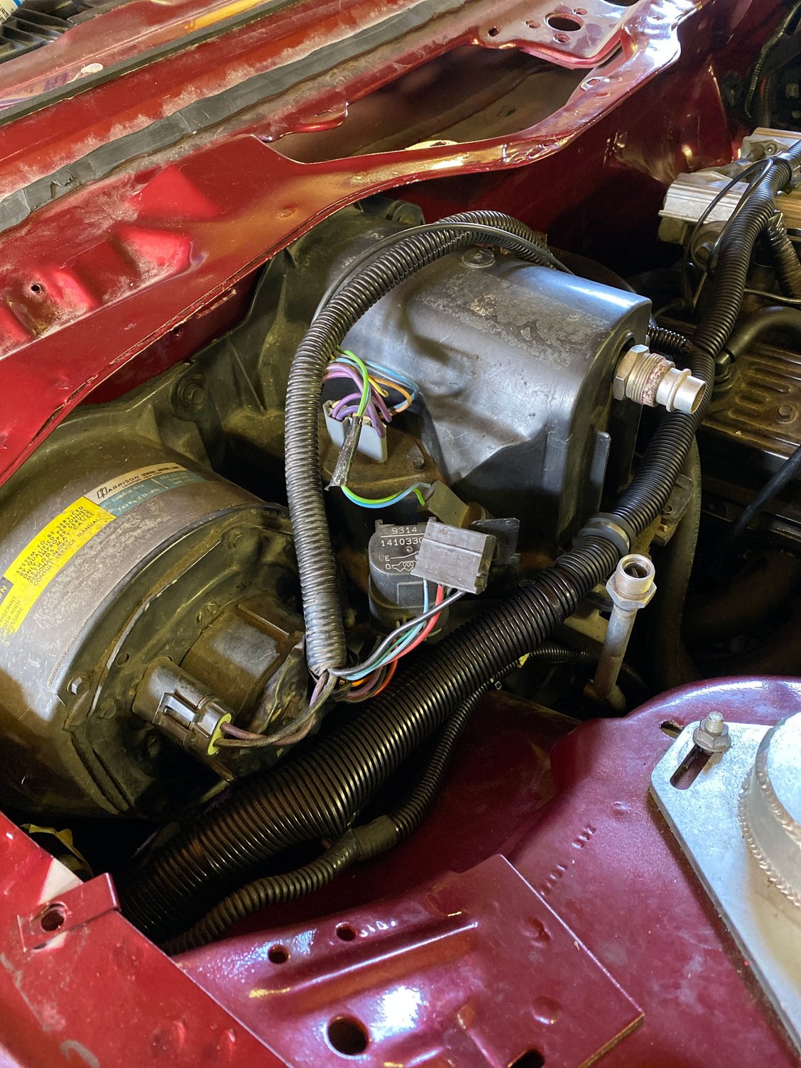

Need help again! After engine swap and wire harness modification Missing one plug that powers the blower motor ( 3 wire plug ) can anyone tell where does the wires goes and what does the light blue wire do?

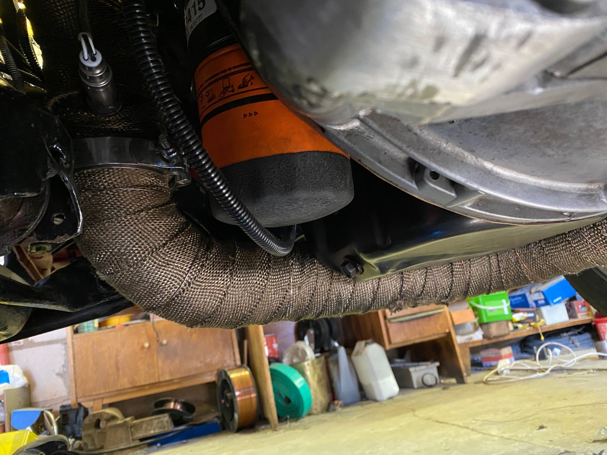

Little upgrade. Stainless steel exhaust with Hooker 2460 headers and 2 Hooker Aero Chambers. New Sparco R100 Sky seats. Had to fabricate brackets to install them.

Can you provide details on the sound insulation you are using, also any info on the carpet?
Finally, looks like custom brackets for the driver side, what about passenger side?
There are lot of different ways to use insulation and also lots of brands to use. I used STP products and after i run them out bought from local sound shop similar products from.
Try this site but you need to translate it: https://stp-russia.ru/calculation/
Carpet is from rockAuto with massbacking.
driver side has custom brackets because the bottom was restored years ago.
Iam using these seat rails on both seats https://stance.ee/toode/sparco-istmesiinid/
and customised these brackets for drivers side https://stance.ee/toode/sportistme-k...d-madalad-fia/
On passenger side i use brackets from the factory seat.

Thats what Scott from bigbrakeupgrade wrote me:
So each has a modification beyond the spindle to consider, the V1 kit is a 14 inch rotor but the rotor (2010-15 Camaro ss front rotor) has a smaller pilot hole (67.5mm), this needs to be opened on a lathe to fit an earlier register (2.78 or 70.6mm) so with every rotor change that has to be done.
the 6TH gen uses a 13.6 but the same pad as the V1, it has a modification beyond the spindle as well, the back of the caliper has to be milled to fit the 3rd gen bracket and spindle, this is however a one time mod, because the C7 corvette used the same diameter rotor and kept the legacy register size you are able to use off the shelf rotors (2014-19 Z51 C7 Corvette)
Cars are ever evolving and the evolution comes from improvements, The later 6th gen caliper is stiffer and exhibits less flex and better pad wear while showing a 5% increase in stopping distance and a total of 18% weight saving over the 5th gen brakes (same as CTS V-1)
Both of these brakes are worlds apart from the stock brakes on the 3rd gen, more leverage smaller pistons for faster activation all make either of them a solid choice. One other one you may not have seen on the site (because we just offer the brackets normally) is the hybrid bracket, this one uses the 13.6 C7 rotor and the base JL9 C7 4 piston caliper, no rotor mods, no caliper mods. Because the JL9 runs on a 12.6 rotor usually the entrance and exit points of the rotor/caliper do get very tight but this is the only area where the two are close, all other aspects work perfectly.
I do believe the 6th gen brakes would be the way to go, I have them same on the 97 and they are fast acting and durable not to mention well balanced, I run them with no proportioning straight pressure to front and rear and the 97 just squats on a full tromp, no tail spin, minimal nose dive--almost as well as a abs car with more potential brake than traction.
The 6th gen or C7 Z51 set up is only a one time deal and the 3rd gen you have has the correct register, its the way to go imo...if you want to completely fill up a 18 the Vs will do that but if you would rather have a most efficient brake regardless of the small difference in rotor diameter those are the way to go.
Hope some others will find this information also helpful.
