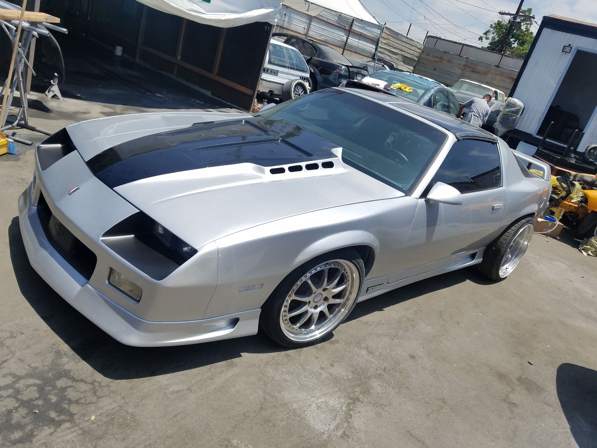

I went to go check out the car and it's coming along very well the shop has had a hard time blending the panels in but looking very good. What you guys think?
