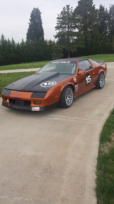

I forgot to add a photo here of the car with the new hood and vinyl numbers. Here she is as we are moving out of the old place.
The metal frame that is around the window area is to stabilize the lexan windows so when I travel on the open trailer it is dry inside. I take those out (2 10MM nuts on each side) before going on the track or to an event. I might find a more elegant solution but for now it works for dry storage and will work on the drag strip or track days which require windows.

Re: Building my car for C Prepared - SCCA
The wheels are Real Racing 16x10 wrapped in Hoosier A6 275. I don't know the offset but there is only a very little bit of rub and only at full lock

Nobody to play with in CP in East Tennessee so we've put interior back in it, (mostly) bought some BFG, bigger wheels and brakes and we are running CAM-T this year.

2 fastest runs from Sunday. At one point I needed .011 to get a trophy spot away from a guy and I did that on my last run (video here), but he went right back out and went faster too -- so I ended up .02 out of the trophies.
next time, i suppose, the tires were GREEN (Stickers) and I know I made some mistakes.
