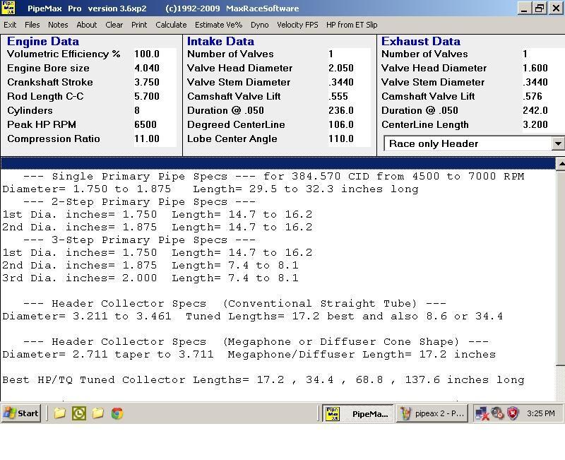

Post your specs as per below and I'll run it through for you. (If you're so inclined).
THAT is exactly the kind of result I'm hoping for once I get to that point. The single full length 3" exhaust is absolutely killing performance. A simple set of cutouts would be all that's needed to add similar improvements as you've had.

There may be more too depending on how close you are to optimum now. It's crazy how a few inches one way or another can make or break a combination.
I go back to the times when my headers were freshly installed and the car had to be "delivered" to the exhaust shop. Driving around, the headers open and nothing more than maybe a 6" long collector (primary tips to flange) and the engine was complete slug low in the RPM range.
385 sbc 4.040 bore. 3.75 stroke. P2d .012 head gasket .027, quench .039, +5cc flat top pistons with 2 reliefs. Afr 195 heads 218 cfm exhaust 280cfm intake@.550 lift comp xr288hr cam. 288/294 adv. Duration. 236/242 dur at. 050. .555/.576 lift with 1.6 rocker. 110 lsa installed at 106 centerline. 11.0:1 compression, victor jr intake 2999 version which has 1 inch taller adapter built in, holley 750 carb with proform main body, double pumper mech. 2nds.

Re: Afr 195 eliminator heads
Based on a couple of assumptions:
Looks like a 3" + collector at 17.2" is the ticket.
8.6" for more HP (sometimes)
34.4" for best TQ.
34.4" for best TQ.
Do you think peak HP comes in about 6500? Maybe closer to 6000?
Dropping peak HP RPM down to 6000 stretches the collector to 18.6".
Considering the worst case is about 28" there's some margin for a good result even if you're off by a couple of inches.
