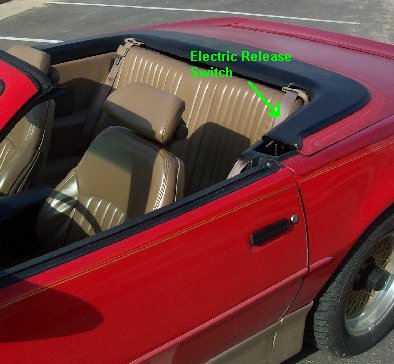

This is the lever you pointed at right?
This is not electric on mine. All it does is pulls a cable to release the latch in the top by the rear window.

Originally posted by patrickm00
the power release for the tonneau cover is in the back seat by the release handle for the top.

The electric tonneau release for convertibles (note the spelling, "i" not "a") moved to the position Patrick shows in 1992. Previously the switch was located between the window switches, where the hatch release switch is located on coupes. The new switch location makes a lot more sense. It eliminated the "duck in to pop the switch" step.
Lon
Lon

Mmm time to make a remote switch so when I pop the top the tonno pops to.. should be easy with a little wire and a wot nitrous switch....
Thanks

over the weekend, i went and traced down why my power releases didnt work. turns out the power wire was shorted to ground under the carpet.
i wired up a new circuit for it (fuse, relay switch) and setup the switch(push button actually) next to the handle you pull to release the top.... its the best vert specific mod ive done so far..
now to lower the top, you roll down the windows, undo the latches, step out of the car, reach in, pull handle,lift rear of roof, push button, cover pops up, lower and fold the top, and click the cover down...
sounds like alot when you read it, but its soo much better then having to reach in and hit the switch in the center, and its worlds better then pulling the little cords.
anyhoo, just thought id pass the idea along.... move the release button to the cover itself... :lala:
oh, and im going to put a trunk release switch were the orignal cover release switch was...

all i did was move the power top release button from the center of the console, to the edge of the top by the handle.
that means that once i step out of the car to pull the handle and release the top, i dont have to duck back into the car to release the cover...
matter of fact, it started to rain at a redlight today and i put the top up in what had to be under 5 secs....... much qucker then the factory 91 way..:lala:
