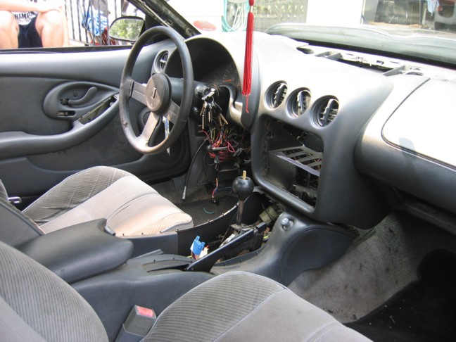

Mine were a PITA..still dont fit that well...they are better but still dont fit right... Buit I love the look of my door panels and my dash....just have to cut the hooks off the back and then screw it on...kinda easy but alot of cutting and bendin to get it to fit..
