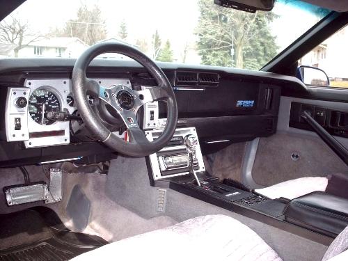

i did with krylon fusion black i took all peices out washed with dishsoap hung on cloths line and sprayed them this is a bad old pic speaker covers are gone now nice black ones now lol

heres another
