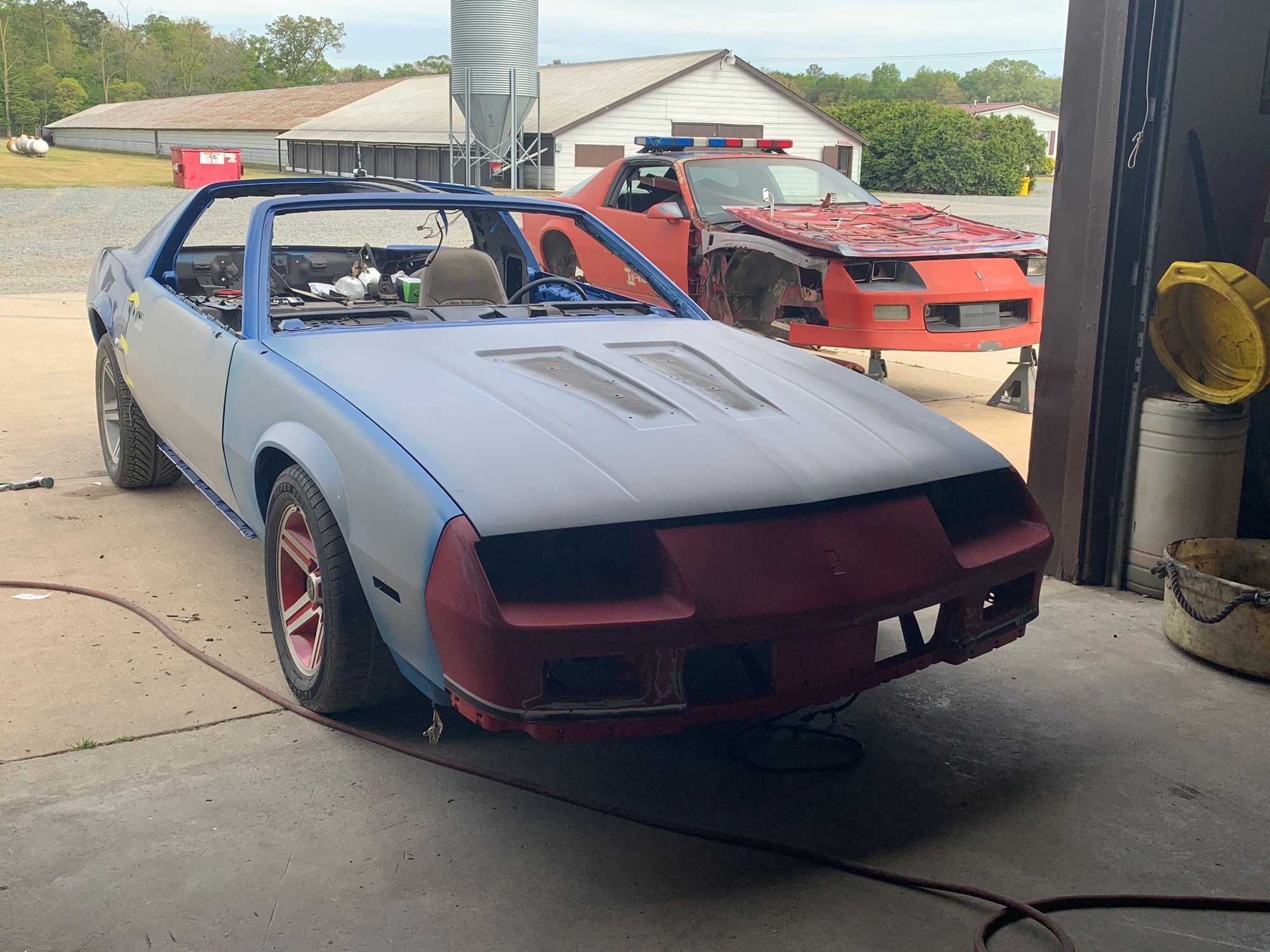

Thanks everyone for the kind words! Itís super exciting to see this thing start falling together. Hereís an update on photos from the weekend
KYB struts but I searched hard to find drilled and slotted rotors thatíd let me keep the factory wheels. Should give it a nice subtle touch.
Springs are from Summit Racing overstock from Hotchkis Suspension. Should give it a nice ride height.
All brand new steering components purchased 2 years ago are finally going on! The steering box was rebuilt and coated in the duplicolor cast iron paint.
Steering column and rear end soon!! Then we will be rolling for the first time in 3 years.

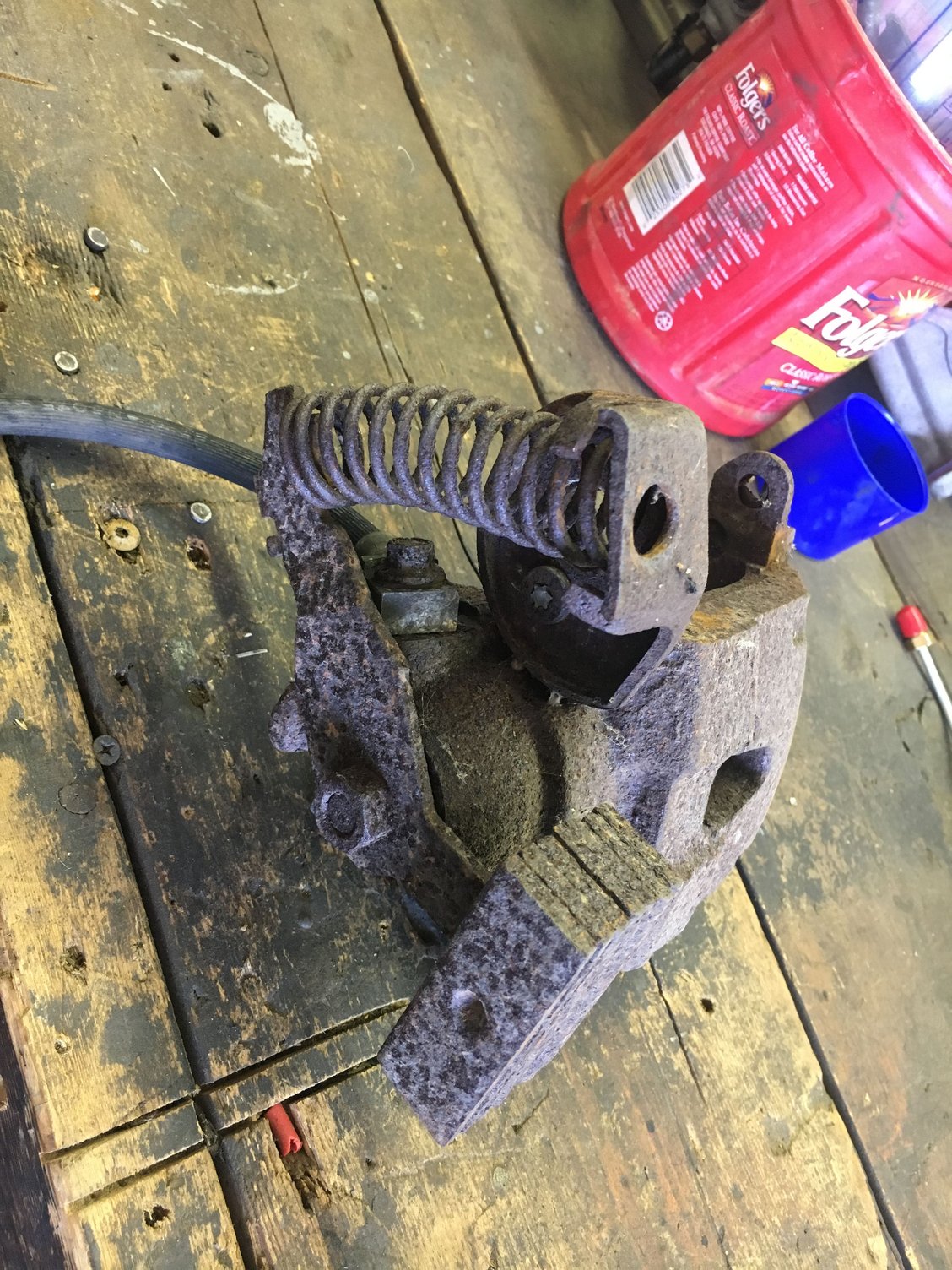

Hey everyone, sorry for the hiatus... Iíve been waiting for Summit Racing to send me the rear calipers I ordered but after being back ordered twice; they finally told me they canít get them. After trying to find them Here is the original one before I began surgery
Finished product
Hardware Kit from Auto Zone, spend the $10 bucks for this!
The misses helping out, pregnant and all!
FYI... Prebent lines are awesome; however, donít expect to install these things without a fight. Just need the ďfilter to tankĒ rubber/ steel line to come in and I can button up all the plumbing.
everywhere, I decided to redo the originals; came out pretty good and work great.
I finally have working brakes on the car, no leaks. All brand new lines, hoses, master cylinder and booster. Even had my wife (5 months pregnant) in the shop helping bleed them. For anyone rebuilding rear original calipers I attached a photo of the Auto Zone parts code for the little clips that hold the pad on, hopefully it saves someone some trouble.
