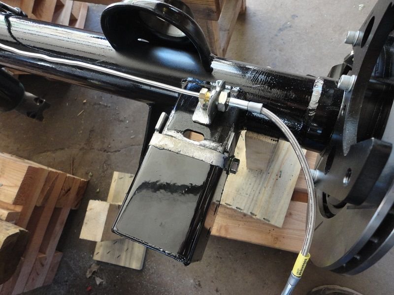

Was Working Under The Car Yesterday,Took A Couple Pics The Hard Brake Line Comes Down From The Axle,Does A 180 And Bolts To The Caliper.

original hard line to driver side
this is a pic of my original driver side brake line next to a new one. for some reason a hard line to the rear driver side delco moraine is correct

Stock 9bolt

Mark Williams 12 bolt:
