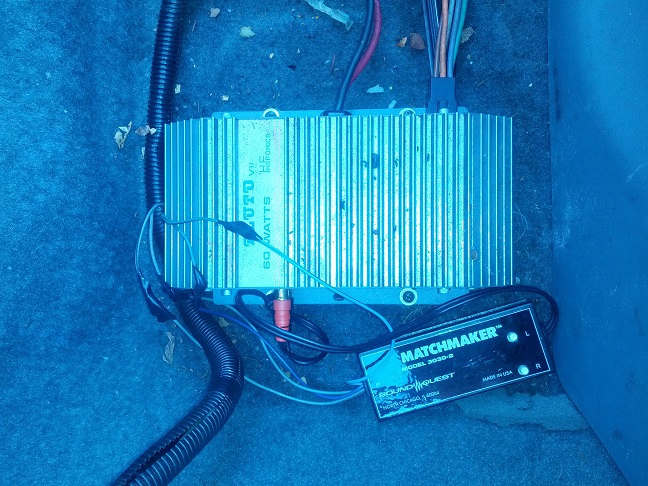

Hi gang
A long time ago I added a Lanzer speaker box to the back well of my car. They installed a Hifonics Pluto VII 60 watt amp along with a Matchmaker box to tie into the rear speakers I believe. The original speakers in the box were bad so I replaced them last year. However I can only get sound out of one of the speakers. I know I messed around with it and got it to switch from the right to left speaker, but not both.
I am thinking the amp and matchmaker need to be replaced as well. Can anyone suggest a similar AMP? Seems most are 100 Watt min, not sure if that is too much, etc.
Pics below. thanks!
Pics below. thanks!

looking at the photos, it seems like whoever installed your amp extended the speaker wires off the desk to the trunk for that amp. I bet if you check the wiring behind the sail panels, they tapped into the speaker wires there.
Based on your post, i wouldn't worry too much about the wattage rating. You're going to have to tune the new amplifier anyway, and if the output is too high you can adjust it down a little directly on the amp. I wouldn't replace it with a 2000 watt amp though
. If you only get sound out of one channel (which you confirmed by switching the sub connections), one channel in your system is burned out. If all four speakers (fron/back) in the car still work, then either the matchmaker or the amp burned out a channel. Probably not both though, so i doubt you'll need to replace more than one unless you really want to.
As for the matchmaker, it looks like that's just a line converter. It allows you to take a high level output off the headunit (that normally goes directly to the speaker) and drop the voltage to something that is appropriate for an amp. They usually have RCA connectors, but not always.
The cheapest option (if that's a concern), is to just buy a new line converter off crutchfield or sonicelectronix and replace the matchmaker. Any brand will do, but you get what you pay for in sound, so plan accordingly with your budget. If that doesn't fix the issue, then the amp probably needs repair/replacement. A Kenwood KAC-5206 seems like it's been well received, and is similar in power to what you have installed there.
