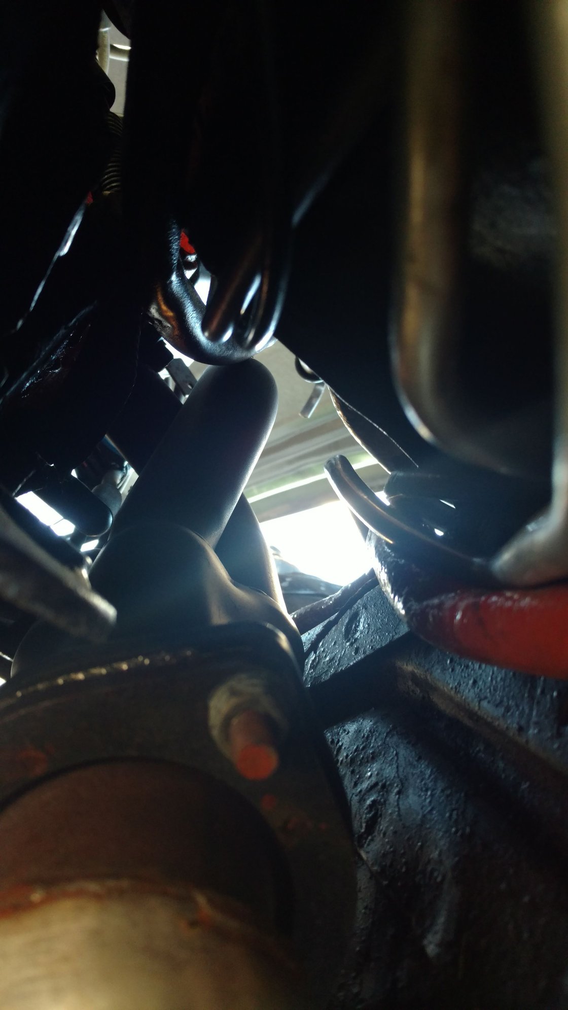

I crossed mine over at the trans mount, then ran it up the passenger rail. I'll try and get a picture tomorrow.

Sorry its late, not sure if you still need it but here it is.
The line wrapped in orange heat wrap is the fuel line
