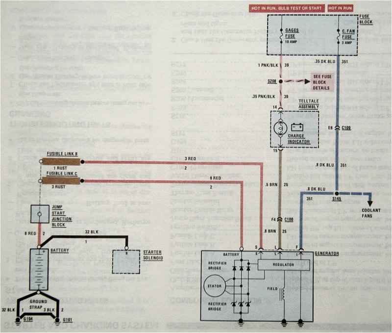

This may help you if you just want to rewire the alt.

Brody,
Just run a 10 gauge wire from the back of the alt to the pos of the battery. Also you can run the red wire from the plug (that plugs into the alt) to the post on the back of the alt.
