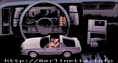

This is my dash:
That entire right pod on the side of the steering wheel doesnt work. HITHERE have no idea on where to begin to look for whats causing it not to function. Help!

i had to take mine apart and clean the contacts it sucks but all works =) before i really had to mash the switches to get it to work, and i also used contactor cleaner and Q-tips to clean all electrical point up
