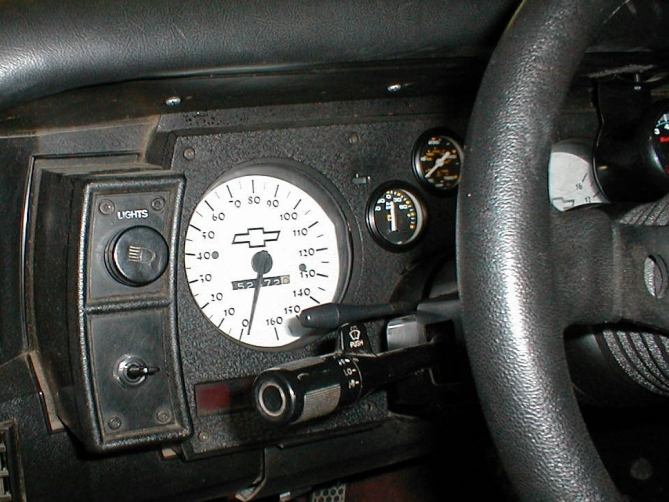

Strange, mine work just fine with half of it cut off. Added some custom white faced guages(printed with photo paper. I considered the problem with 'weight' of the needle and figured if it didn't work I'd just get a single pointer.
