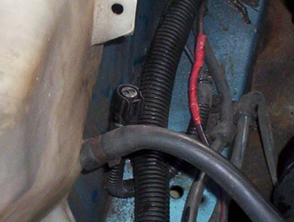

well guys after looking at the ghetto wiring job my car came with i'm gonna fix it. now heres the problem i have a few wires that i have no clue where they go or what they are for, anyone have any ideas i'd appreciate it
heres a pic of the are of the engine they are in

That looks like wires or the AC. The two in your hand goes on the AC compresser( 1 to the clutch, 1 one the back to a pressure switch) the one by the coolant overflow should go to a hight pressure switch on the AC line

hmm my car came with ac delete though
did they leave the wires in anyways?

Did it come from GM without AC? If so they may use the same harness either way. You can tuck them away in the harness and make the engine compartment look cleaner or remove them if your not ever gonna install AC

yeah it was ordered with no ac (or so says the rpo codes
i guess i'll just tuck em away

I have a 90 RS 3.1 I bought from a guy down the road after he knocked a hole in the oil pan and locked it up. I looked at it and those connectors look the same as what you have and are in the same place. I'd just tuck them away myself, I'm not one to go cutting up a wiring harness.

nah i'm not gonna hack em up, was just curious what they were
