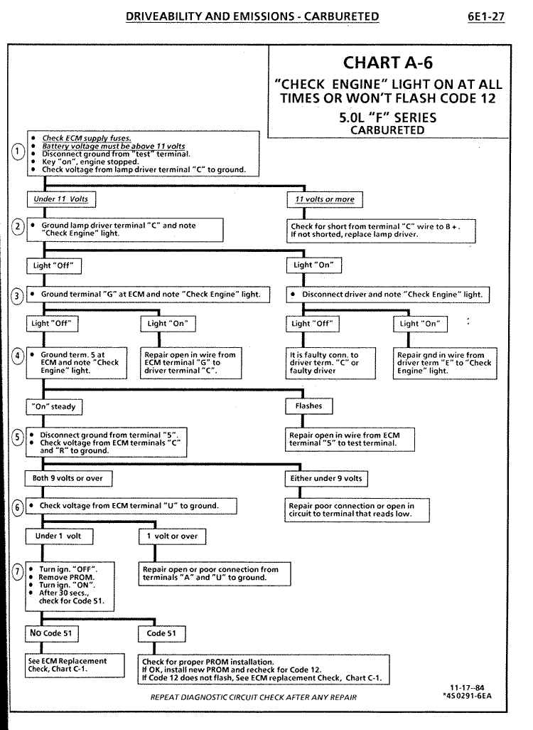

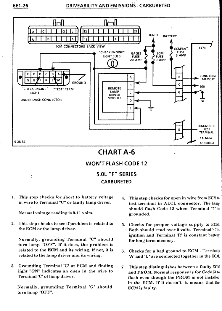

Here is a diagnostic troubleshooting chart for your problem, it is out of a 1985 firebird GM service manual and not a Haynes or Chilton's. I would send you the one out of a 1982 manual but I have not received it yet. However this is close enough to give you a general idea of the problem and how to fix it.

page 2

So what do I need to test all this stuff? A voltmeter or something like that?...and thanks thus far.
Old Jun 22, 2004 | 05:43 PM
Trickster's Avatar
Posts: 6,127
Likes: 12
From: conway, s.c.
Car: 1989 Iroc-Z
Engine: 5.7L TPI
A volt meter and a jumper wire will put you in business.
