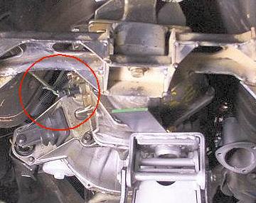

I was wondering if anyone had a pic of the reverse light switch because mine do not come on when i shift into reverse and i could not see a switch when i pulled up the console around the shifter boot. The car is 1985 camaro 350 hurst shifter manual.

I would first check the "TURN-B/U" fuse in the fuse block. If that is good, then I would look at the back-up switch located in the left side of the transmission

To add, while I wasn't taking a picture of the switch, it can be seen here on my t-5....
