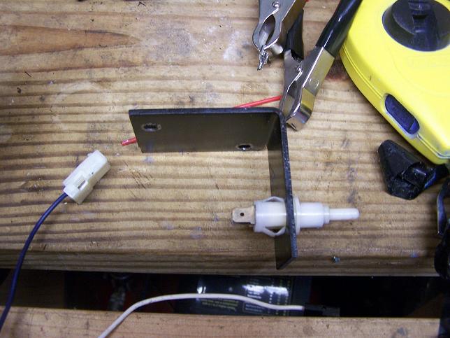

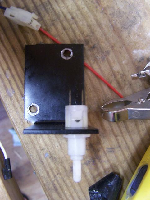

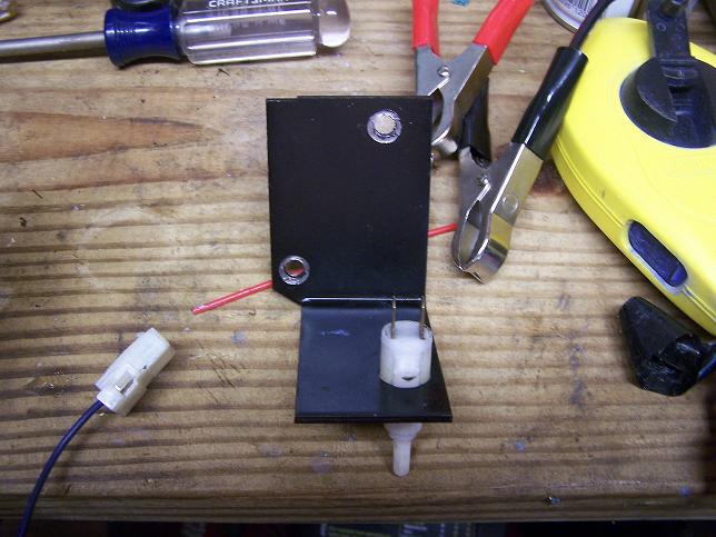

And finally, can anyone tell me what this switch is for in these pics? It has two prongs on the bottom that do not appear to have had anything attached to them, their color is evenly dull unlike what it would look like had there been something attached and removed.

That last switch seems to me it's aftermarket for an alarm/security system and possibly the hatch compartment light. Either way it's DEFINITELY NOT factory. I have never seen one of those on any of the parts cars I have seen that still have their pulldown units, nor mine.
