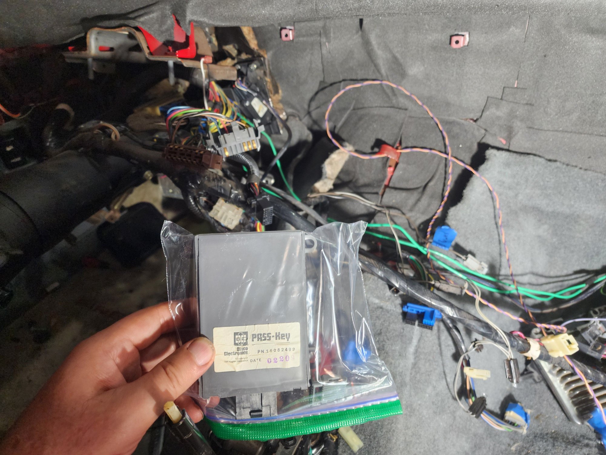

Old Jun 3, 2026 | 04:10 PM
  #161
TEDSgrad's Avatar
Joined: Sep 2010
Posts: 1,627
Likes: 47
From: Double Bratville
Car: '89 Formula
Engine: LS2
Transmission: 4L65E
Axle/Gears: MW 3.42 12 Bolt
Re: Tech: How to bypass VATS
And if you have your dash out for Vintage Air, I can show a pic of the Pass Key module.
