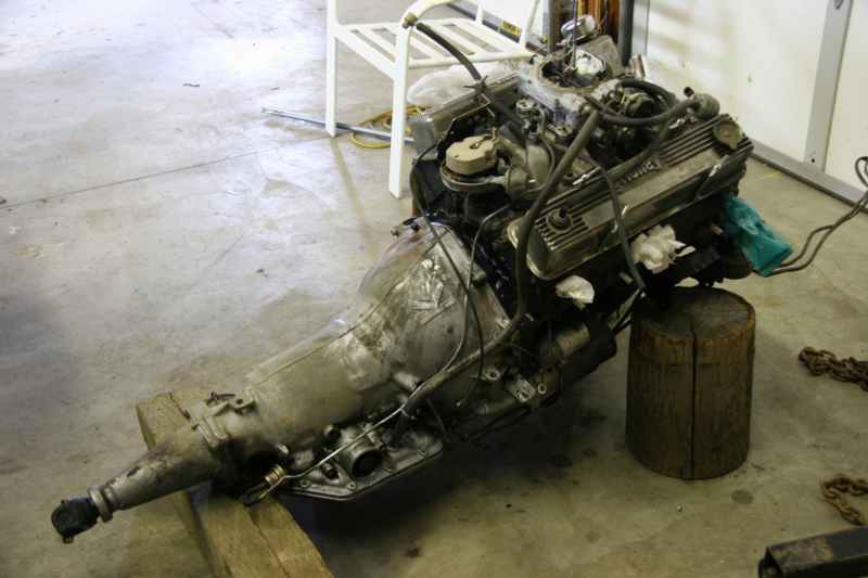

Well, the old, boring motor and Th200c are finally coming out. Going in is a 250 HO with turbo 350 from a late 70s Chevy pickup that was my uncles, which was involved in a head on..
My engine and tranny are still in, the new engine/tranny is out and getting ready for accessories.. Here's a pic...
Lookin forward to this toy, trying to get it done fast for summer cruising..
Looks more like a 350 to me. . .
Looking good. You have the 9" tailshaft TH350, which is a good thing so your driveshaft will work. I assume you have plans for the torque arm mount.
I knew I was forgetting something, the 9 inch shaft is what it was.. That's good to hear...
The nice part about pulling an engine from a totallyed truck? If a part won't come loose? cut it... Panel gets in the way? Cut it. You scratch the paint? Put a dent in it to cover it up..
Now I gotta order the torque arm.. 400 for some metal..
But then again, that's pretty much what these cars are too, so...
