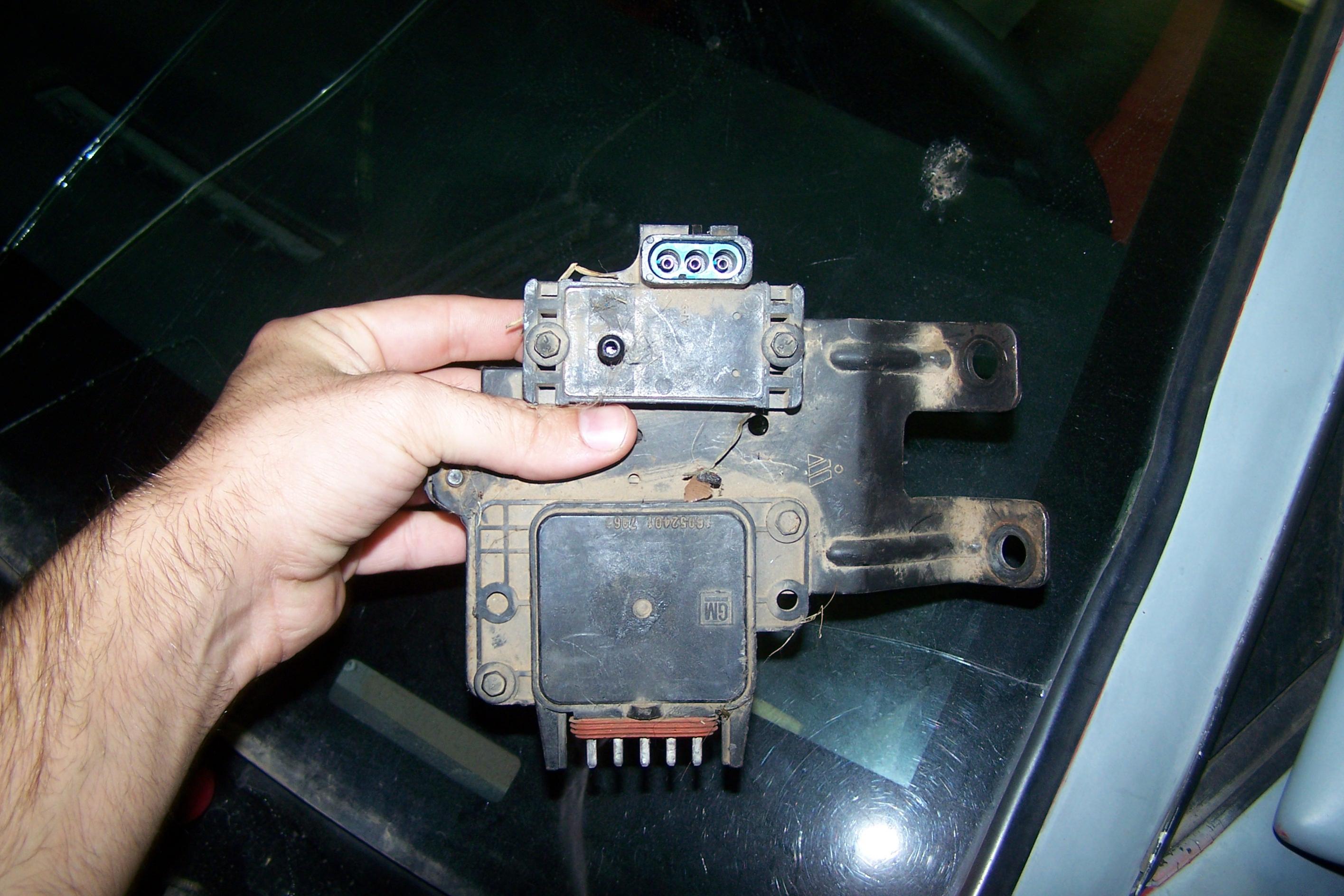

engine pics!(build thread)-digital-camera-169.jpgi this is an extra, is this the knock sensor module? the one that is on the car now is mounted totally different with different components around it.

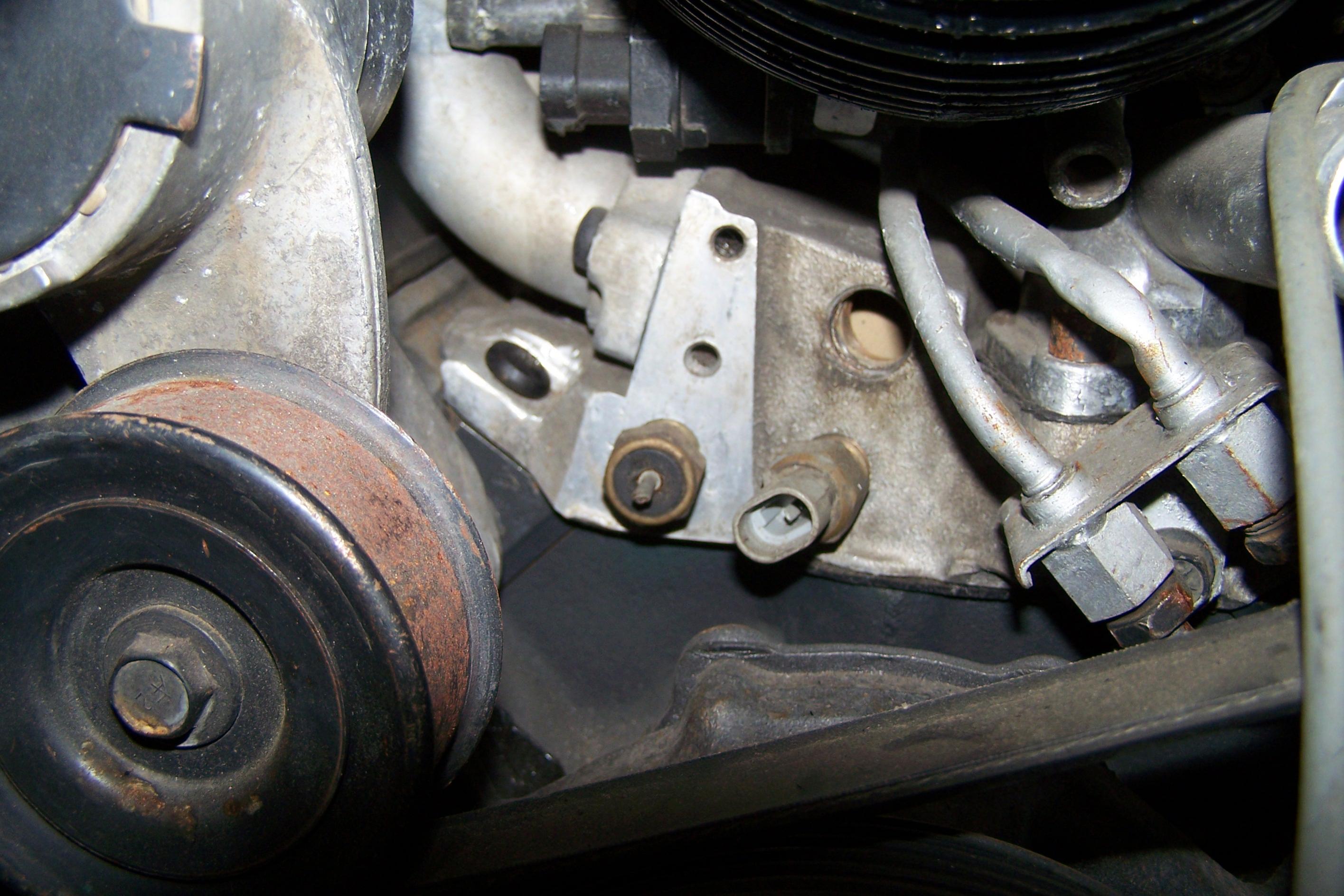

engine pics!(build thread)-digital-camera-170.jpgwhat sensors are suppose to be in front on the tpi set up i think what i have in there is wrong so i am going to buy whatever is suppose to be there! thanks guys

Re: engine pics!
1st pic
top = MAP, bottom = ESC
2nd pic
coolant temp and coolant temp one for the ECU and the other is for the cold start injector

Re: engine pics!
The temp sensor for the cold start injector has that kind of connection, your sensor is shot..here's a pic of one how it should be: The one on the left with the brown connector.

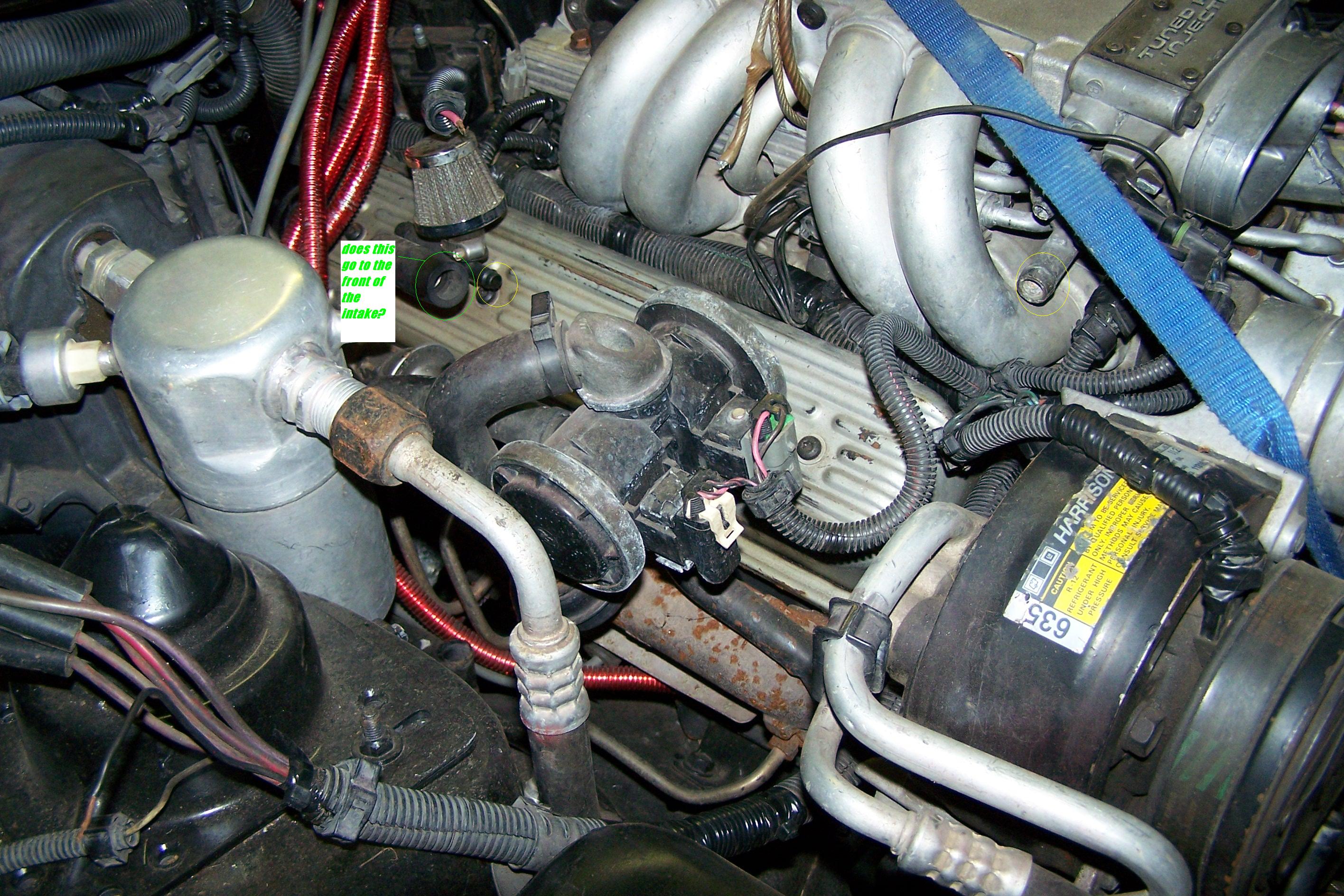

any info on the clutch fork? or the other pics i posted im trying to find out where those hoses go!

The first one that has the yellow to yellow I am almost sure they connect I know in my fire bird my PCV valve runs into the intake, why did you disassemble it? what's the vehicle make model and year, I might be able to pull up a diagram for you

Re: engine pics!
i pulled everything off the 305 to put on this 350. its 1988 iroc z28 350 tpi with t5
