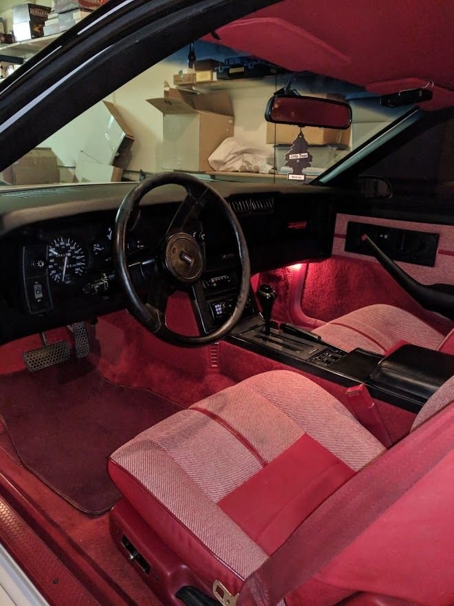

Not super "low"... but given the year. Not Bad.
Pics of my girl...

I'd dance with that girl
