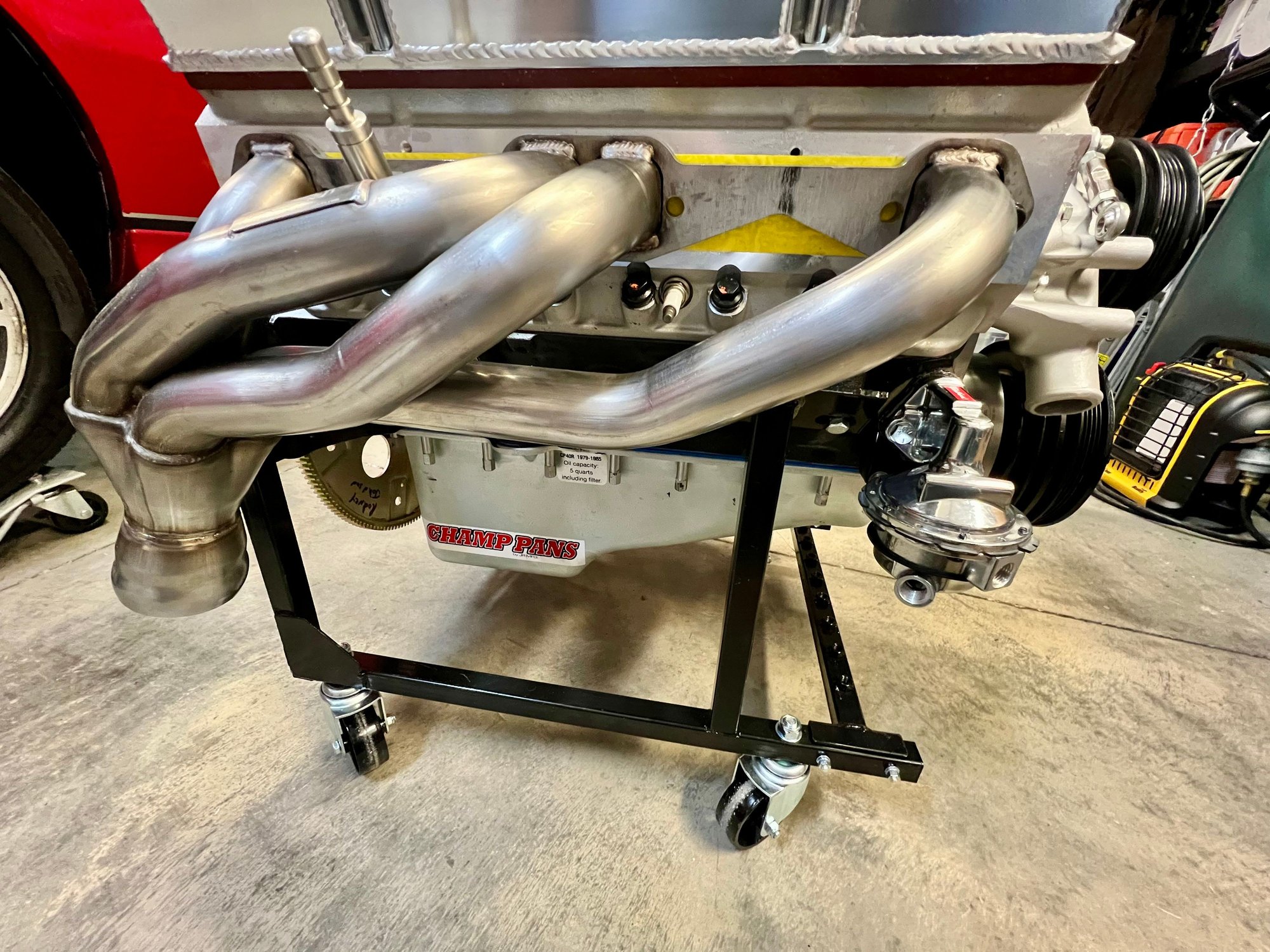

I did a thing 😜
I did a thing 😜

Re: Header selection
What are those? Size/brand I mean...
American Racing Headers 1 3/4”
Did you just get the headers or did you get any other exhaust pipes too?
They came with the pipes back to where the cross over is in the picture. I will install a cross over when I get them installed.
Here are some pictures of the headers test fit on the engine
If you get up under your car and look, you'll see that where the cat now is, is where the little "X" section in the ARH system goes. I'm having a hard time imagining exactly how, butt with some creativity, it might be possible to put a cat there (or 2 of them) instead of the "X" if that's what you want to do. I don't think there's any possible way to put the cat(s) anywhere else.
I would note also, that the pipes in that system, look like they would substantially complicate subframe connector installation.
They look great, have a set ready to go on as well.
