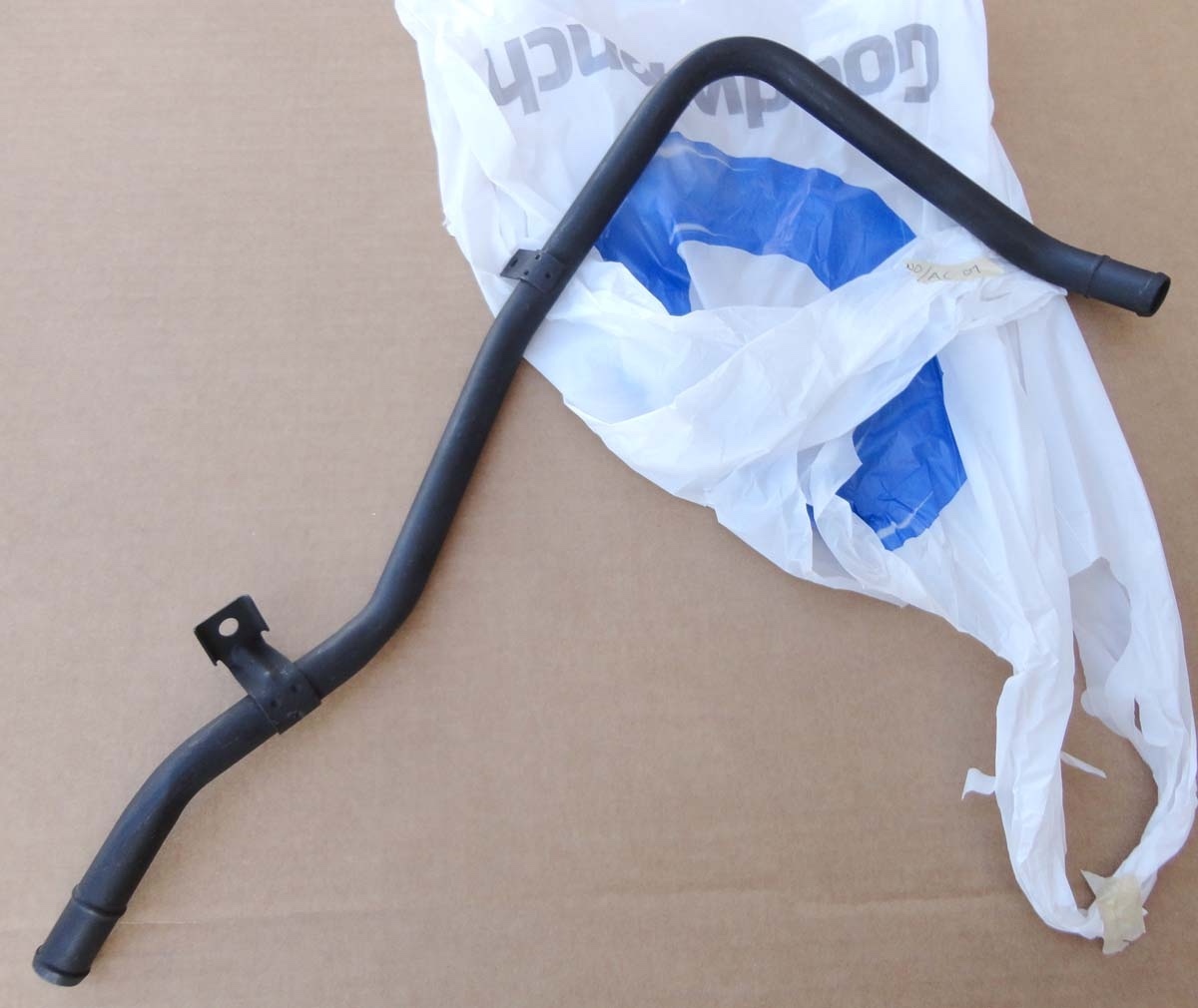

Heater pipes! So, I looked around for a replacement. I found a bunch of '87 and ups with the T for AC. I was ready to get one of those and cap the T. But guess who had a correct one? Our own Drew. Used and not perfect, but appears serviceable.
Drew prepped it a bit, then I soaked it overnight in rust remover on the problem areas and gave it a couple coats of high temp semi gloss engine paint.

Should be able to use as a pattern for the fab shop and have a few extras made.
When I bought mine from the dealer, it had a slight texture to the paint but the 90deg steel elbow (T-body to heater core) didn't have the same paint on it.

Not a bad idea, I guess I could hold on to my old one for that.
