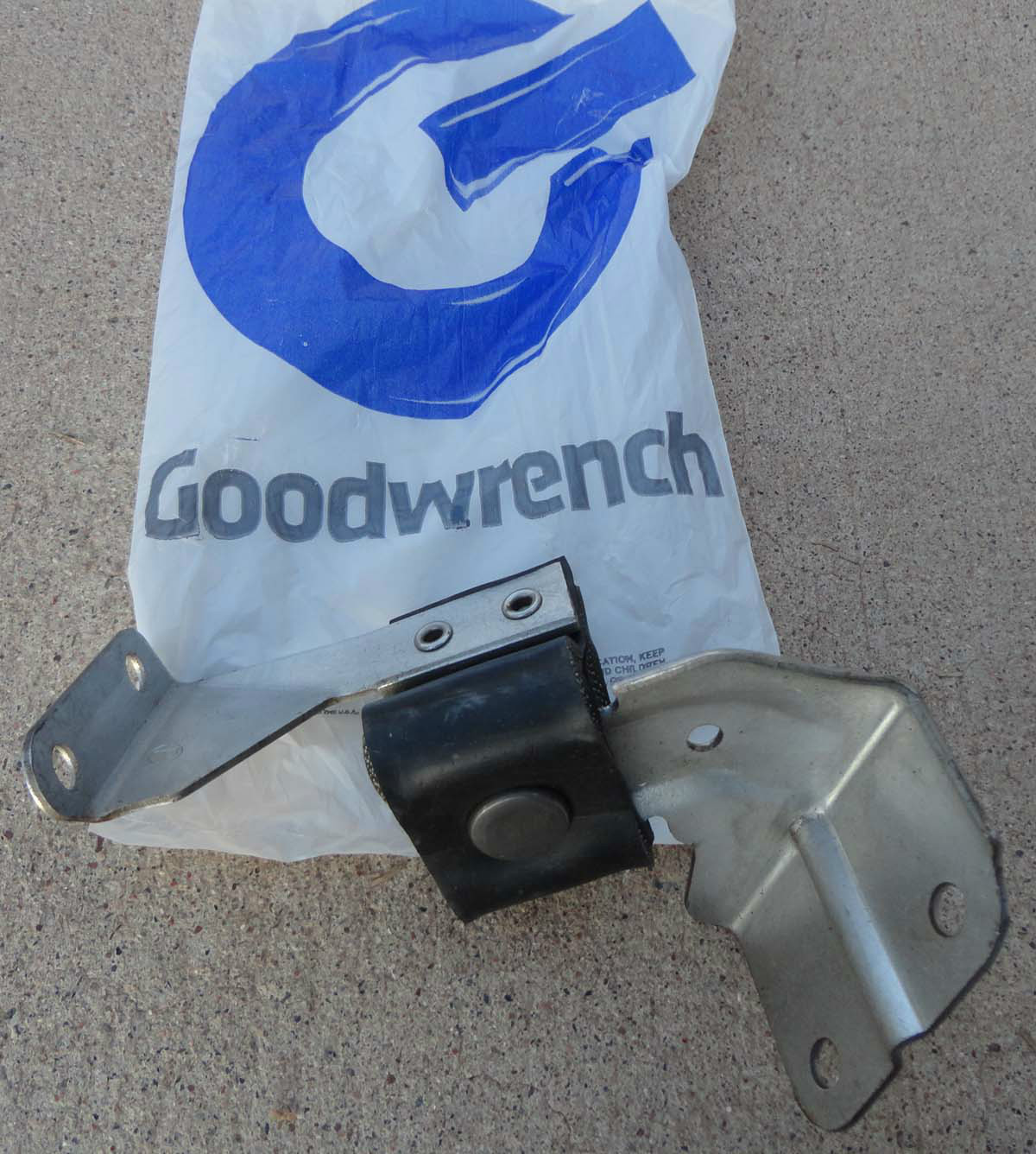

LOL @ the exhaust hanger. I picked up a new one at the dealer for my Formula back in 2000. The exhaust was clunking against my Alstons and I figured a new hanger might help. I finally got around to changing the hanger around 2008. Maybe I should have saved it for some of those sweet sweet Ebay profits.
Maybe I should list all my NOS parts for ridiculous prices like the ones on Ebay. Probably have a few grand worth, at Ebay prices. But I'm not really into collecting parts to make money. I collect parts build my cars.
Sorta related... Anybody compared a T5 dual cat hanger to an Auto dual cat hanger? I know they're supposed to be different, but don't actually have a T5 dual cat hanger around. Do have a T5 hanger, and an auto N10 hanger, thinking I can probably splice them together to hang the dual cats from the T56.

The bracket that bolts to the trans is different. I want to say the bottom 2 torque arm bolts are further apart on the automatic cars, but could be the other way around. Either way, the trans bracket is the only difference, the rubber and the cat bracket should be identical.
