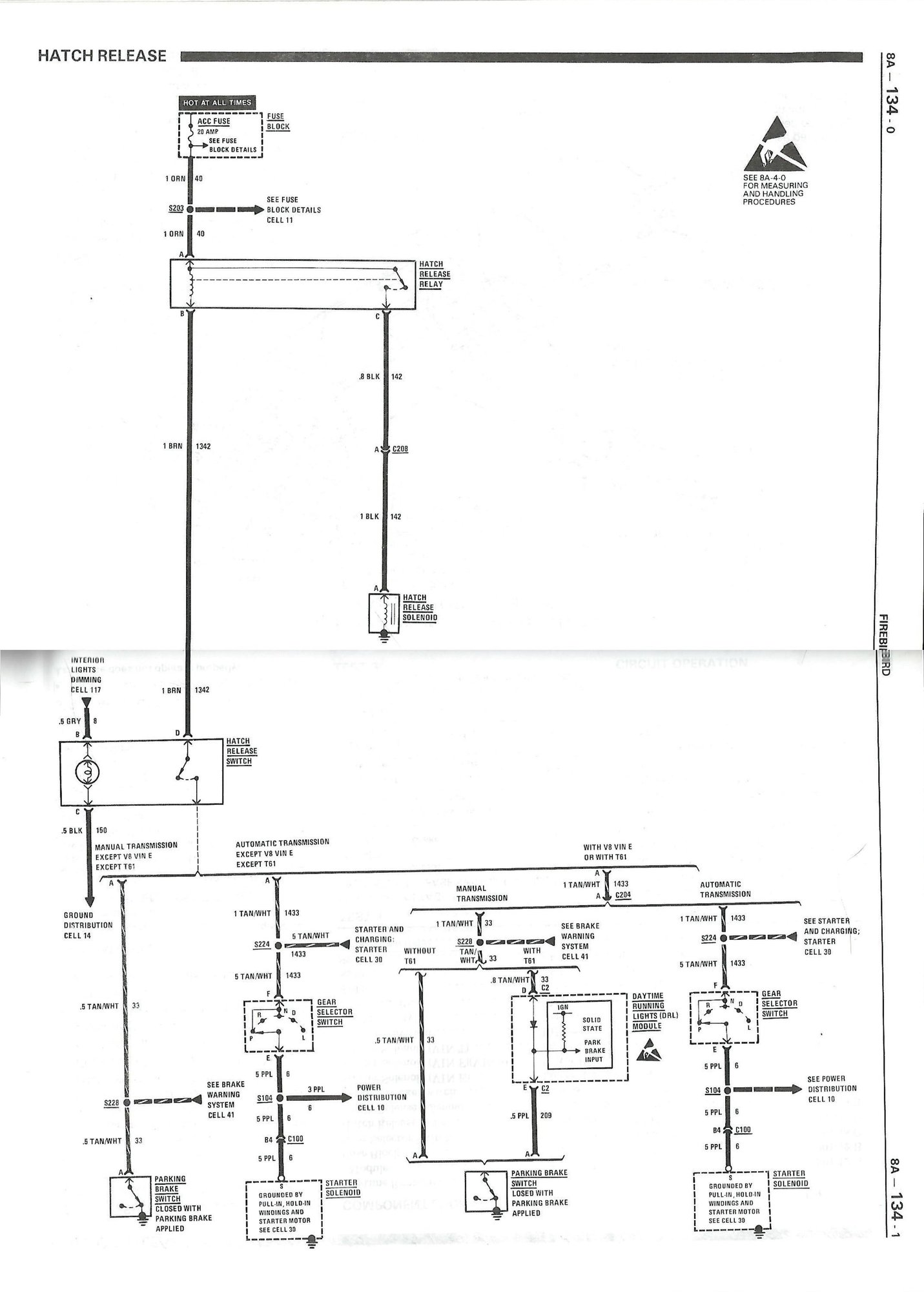

Check that your factory plugs are connected as shown. You might have the E-Brake wire and 1 of the hatch switch wires crossed. ( plugs are the same -or very similar- so it's easy to plug them in the wrong spot.
This schematic is a bit easy to follow:

Schematics are from an 85 or 86. I know that later cars were wired for multiple option combinations and the hatch release wiring could be a bit different in later years.
you just to be in park/nuetral
Yup; As the diagram shows; for the automatics relay ground got passed thru the starter & wasn't applied to the relay unless it was in Park or Neutral,..... Manuals required the E-Brake to be pulled so the E-Brake switch would supply ground to the relay.
If ground was always applied to the Yellow wire on the Hatch Release Relay,..... the hatch release would be functional at ALL times. ( Not a good idea ! )
