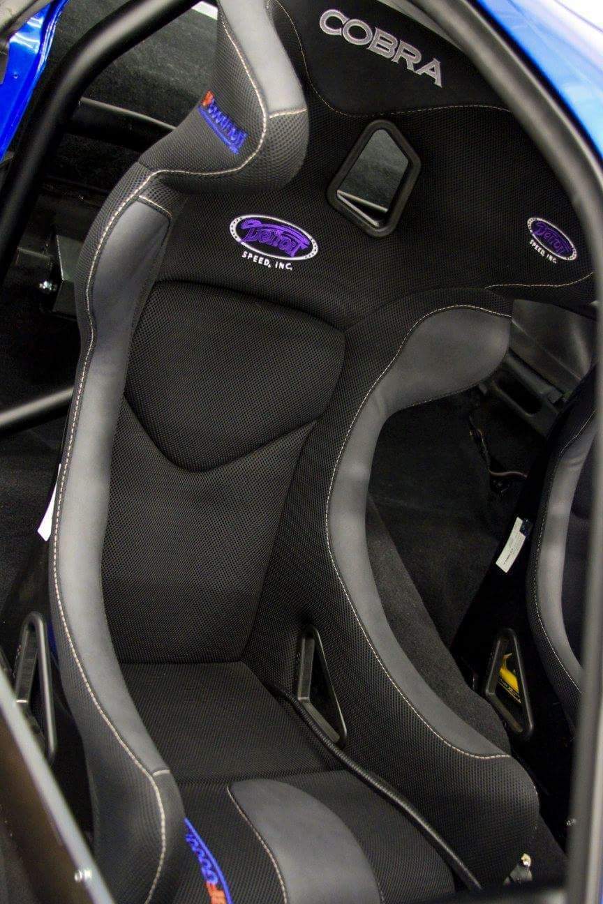

Interior is starting to come together. Hopefully we will be testing in the next few weeks...

We got the switch panels decals installed and next up is the headliner that will be finished this afternoon. We will be doing driveability tuning next week and then testing next Friday.
