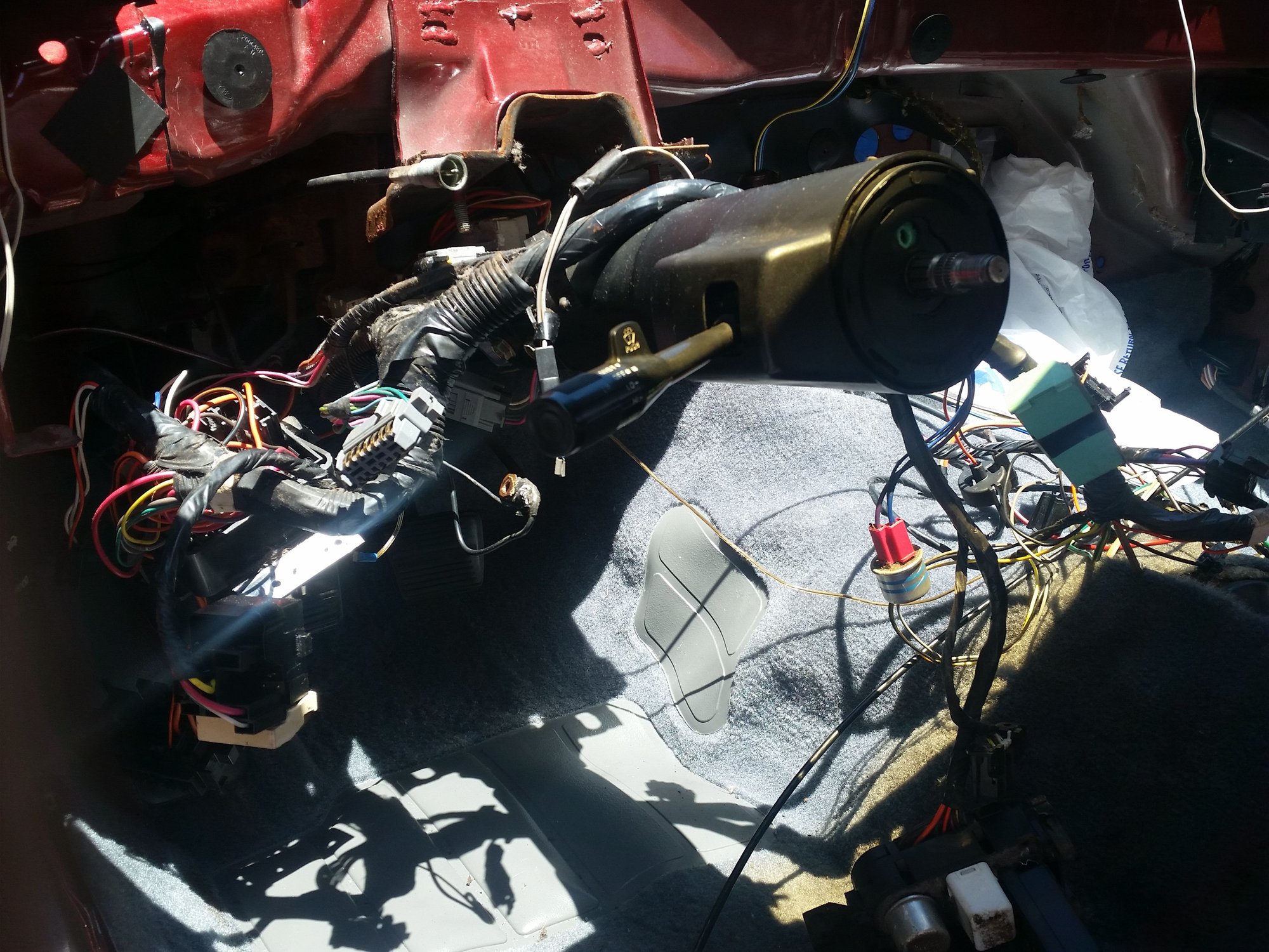

Carpet getting installed and I was checking the wiring for damage. This car had a serious mouse problem but they left the wiring alone.
I had to completely gut the HVAC system and install all new foam. I used E6000 adhesive and some A/C foam from home depot that I picked up for like five bucks.
Painted the HVAC blower motor housing using ultra high temp paint - I prefer the flat black look for parts like this. I had to scrub the insides of this from what the mice had done to it....
