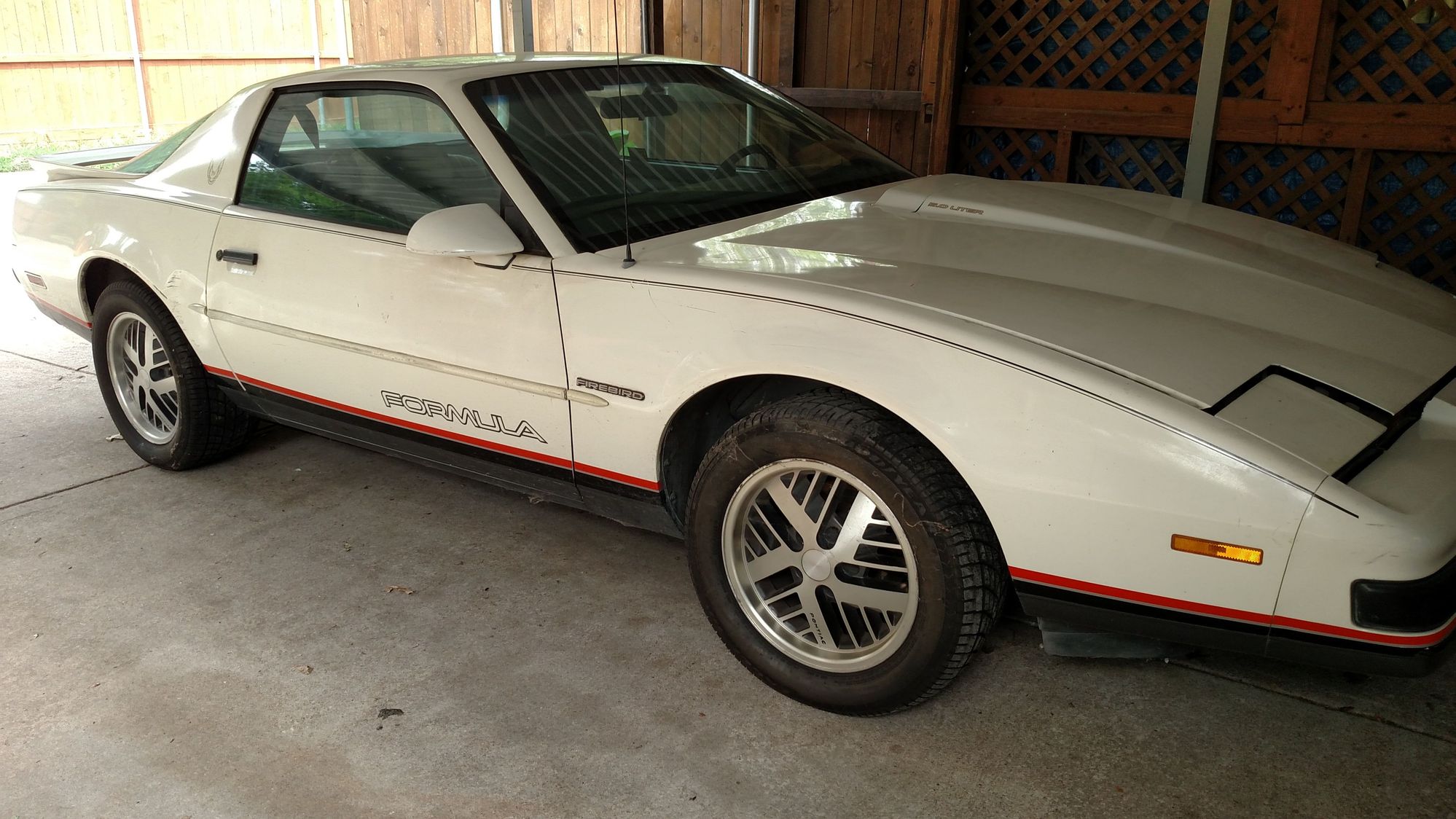

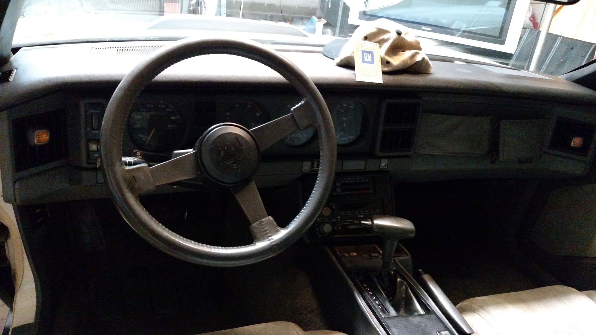

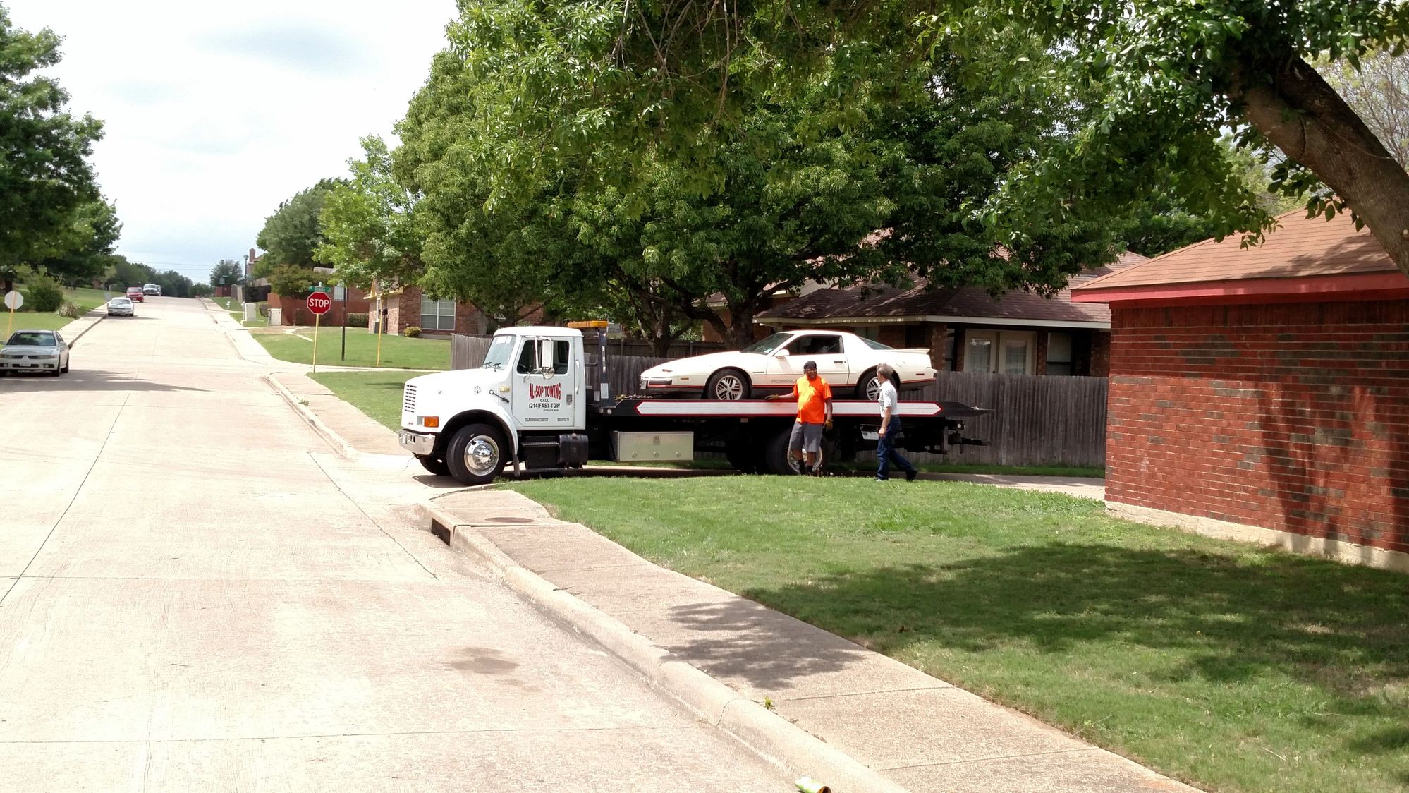

By popular demand, I am starting this thread about my recent find.
Three weeks ago I found a 1987 Formula Firebird posted on Craigslist. The car was a one owner, and had been garaged since 2004 for (allegedly) failing emissions inspection. Quite possible though since it was around that time that Texas introduced the rigid emissions inspection laws.
So, short version, I got in touch with the seller and picked the car up from them a week later. $875.00 CASH!!! They also had a neighbor who owned a tow truck who brought it close to 60 miles to my house for $100!!
Got it home and started to bring it back to life.

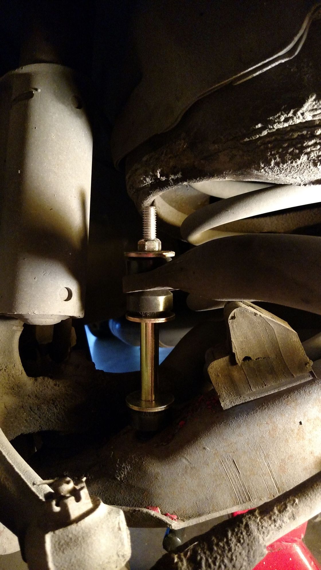

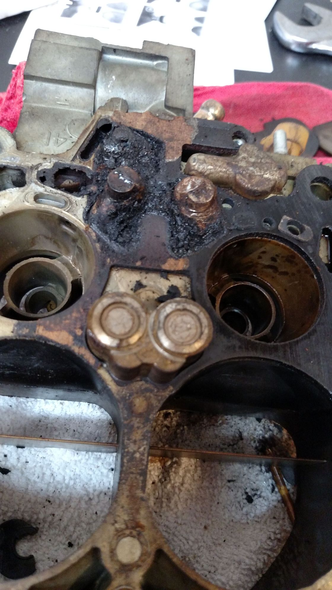

So, to date, here's what has been done:
Spark Plugs changed and oil squirted into cylinders before installing new plugs.
Oil Change
Replaced upper radiator hose and flushed coolant
Replaced sway bar links (original bushings had hardened and shattered)
MAJOR cleaning event with my two boys.
Replaced all engine belts (yes, found the hidden power steering bolt LOL).
Rebuilt carb which had solid gunk in the fuel ports.
Changed transmission fluid, pan gasket, and filter.
Currently fighting the installation of the new mechanical fuel pump. Original one blew shortly after first startup last week.
Oil Change

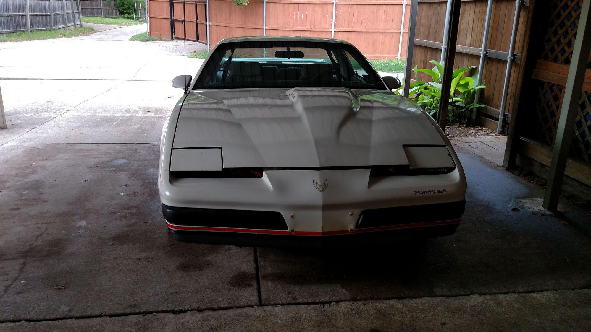

2 tone white, not super common to see, also it has the Firebird badges which were not on the Formula, but everything else looks Formula. Odd indeed.
Curious if you have the RPO codes can see if it was 'converted' to a Formula? I'm thinking they thought the Firebird badges were cool and just added them on after-the-fact.

Ok. So here is the latest update.
This weekend I cut the inevitable hole above the gas tank, and changed out the fuel sending unit.
The car starts up and runs for about 15 seconds then dies. I changed the fuel filter (again) with the same results.
Pulled the carb and it had fuel in it. I'm now thinking that the carburetor has to be replaced next since both the mechanical and electric pumps are new as well as the fuel pump relay and harness.
