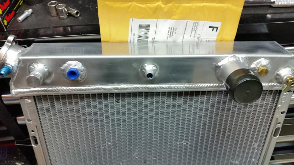

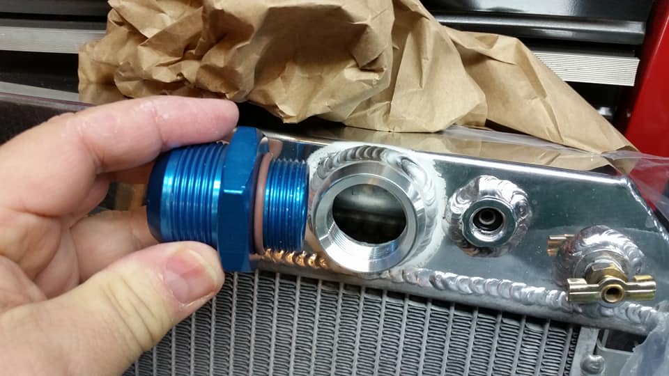

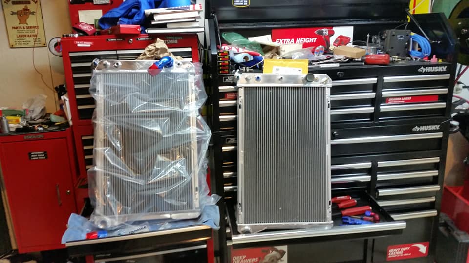

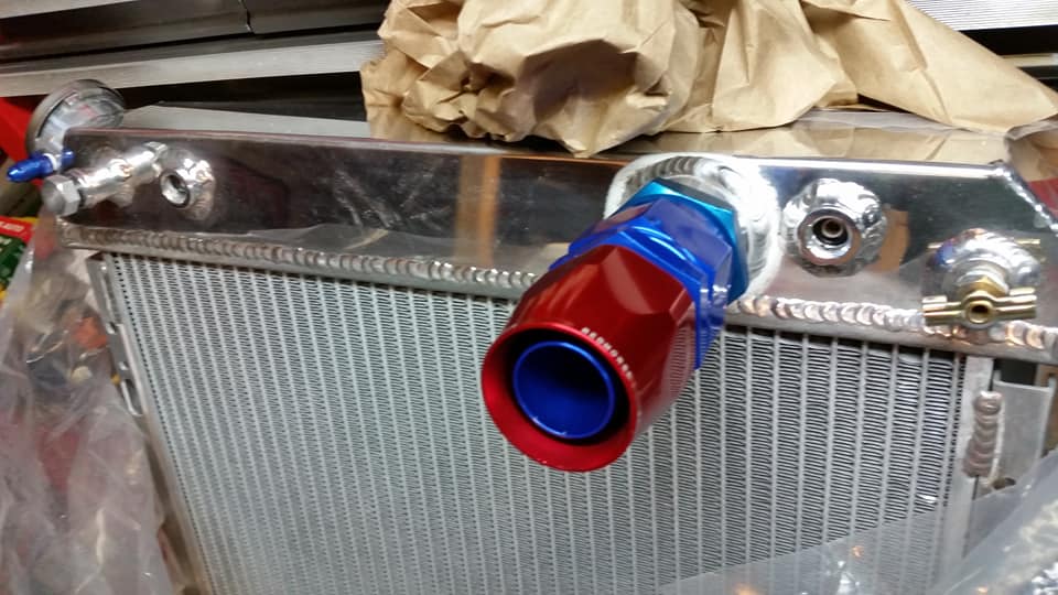

a few updates some more upgrade parts came in.. had a reg 3 core aluminum radiator made for the car..still new in the box...but wanted AN fittings. after looking at there site..seen they will add any fitting .. so I ordered a 2nd one made this time with 20AN fittings.. and might as well polish it also...
with a Hi Flow Electric water pump that runs at the same speed.. I set the new rad up with 2 core. ea core is 1"wide.=.more flow across ..starting off with a 160 deg thermostat & dual Fans..will go from there..with a Aluminum block and heads..I don't think heat with be a problem...when I had this new unit made..I told them what I had and going to use the car for..the makers told me to go with the 2 core.. faster flow across the unit.as the tubes are larger...if it don't cool.. they will make me another...on there dime....so whats to lose...give it a shot..
the one on the right is up for sale..3 core set up with 4AN over flow..and 1/8NPT aluminum plug in the Low coolant bung..
will remove the smugs before install..
looks better with true AN fittings
this unit is for sale..new in box with or without the 4AN fitting for the over flow
