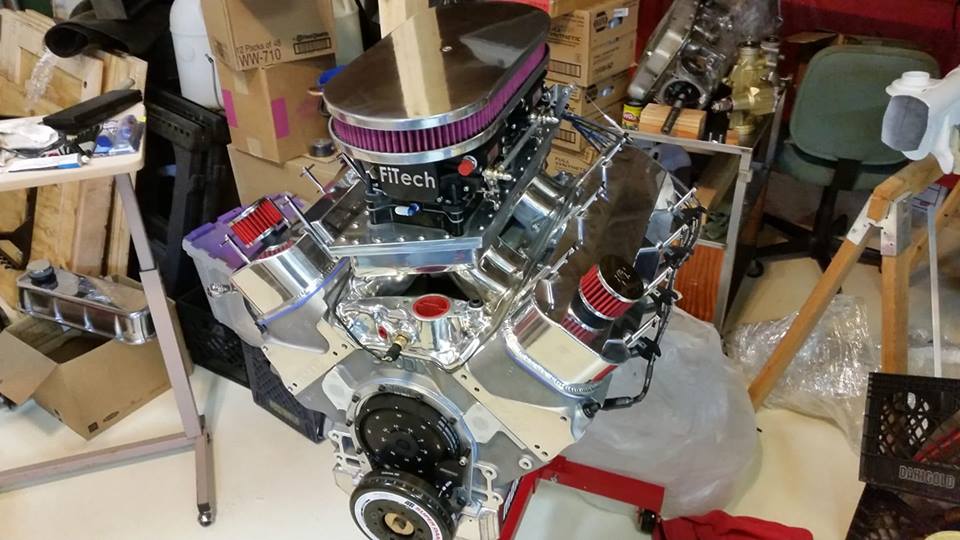

checking out a few things..getting it on a eng stand was fun..as I had to lift one side of the pallet high enough to get the 1 leg of the Hoist under it..saving the crate so I have it to send it back in 3 to 5 years for a refresh..lol asked not to have the cid listed on the valve covers..(615cid) as I might install GM 427 covers... as this is my 427 ZL1....lol

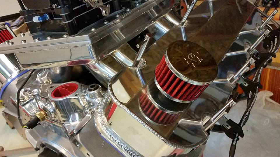

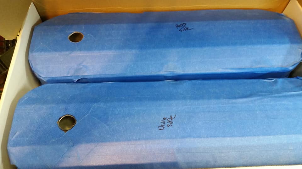

set my valve covers up the way I wanted..no body makes a set like I wanted..breathers at the front with baffles..
wanted the breather holes at the front on both sides. with short screws...the canton racing set is set up with long screws...but looks so flimsy..

the above shot shows the canton racing valve cover..they do not have billet rails...and looks they would leak...but now looks like a stock 427 big block ZL1....(sorta)...working on a better air cleaner to hood set up..going to make the lower pan seal to the hood when closed.to get air from the cowl..

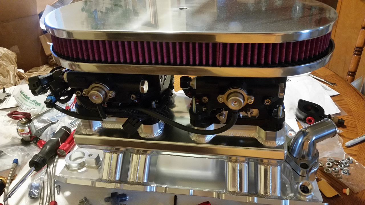

I want a taller air cleaner..3" tall.. can drop the base down another inch..

I've had long screw valve covers and hated them. Needed the tall valve covers to clear the stud girdle and even then, I needed valve cover extensions.
When I switched to shaft rockers, that changed everything. A set of low profile valve covers with short screws fit perfectly over the shaft rockers. Looks much cleaner.
I went with no holes in the covers but at the front of one of the covers is an AN fitting for the vacuum pump. No holes means it has a better seal. Downside is that I need to pull a valve cover when I need to add oil.
#50
Re: 892 horsepower.. on the dyno.with Video
I orderd a Polished set without holes and did 1" holes and added baffles..have 1 breather in ea cover.and was going to add a oil fill cap..like the canton covers came with.but don't want them to look so bissy with a lot of crap on them.. fill cap was only $25 in black anodized.. but can fill by removing a breather..I picked up 2 catch can setups. to do one on ea side.but found I cant order/get a vacuum pump to work with the pulley set up I have....so going to see what I can have made.. had to go with the short screw type covers to work with the plug wire set up they used on my eng. but I like the T handle stud valve cover hold downs.(timing them with washers) to line up) and tigging them the end of the T hold downs..)
