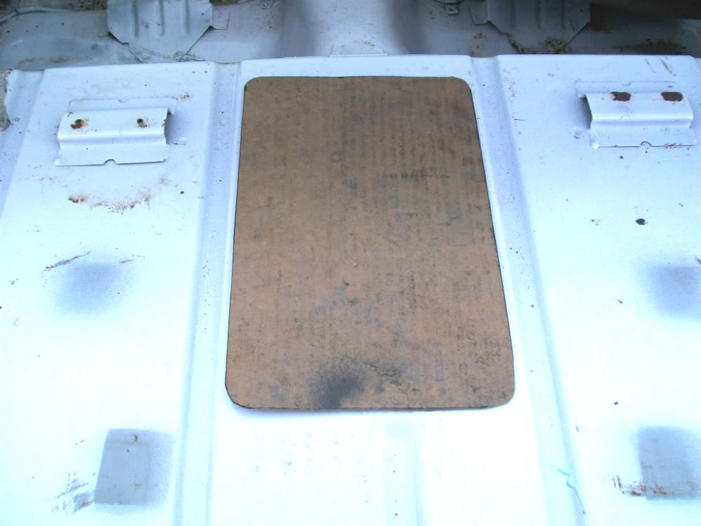

Re: Chronicles of a 9 Second 305 Trans Am, Can It Be Done....
The center of the cardboard cutout was cut 1 1/4" all around from the edge, and the bolt holes were set into place. It was then placed on top of the metal cutout, with the bolt holes marked down, then drilled out. Then place the cardboard cutout back over the fuel pump location, mark the bolt holes, as well as the center area in which gets removed....

So the tank hangs from straps under the car, and you're looking to screw the hatch down with screws, how are you going to keep the tank from possibly bouncing up and puncturing itself on the screw points?
Old May 24, 2011 | 02:35 AM
  #422
Street Lethal's Avatar
iTrader: (16)
Joined: Jul 2003
Posts: 10,539
Likes: 206
From: NYC / Jersey
Car: 1990 Trans Am GTA
Engine: Turbo 305 w/MS2
Is this your first access panel lol....?
There is four to five inches of clearance between the upper part of the tank and the hatch board. The screws will stick out less than a 1/4 of an inch underneath when fastened. Even if a tremendous bump were to occur, the top of the intank assembly (metal fuel lines, fittings and clamps) will hit the bottom of the panel first. The screws aren't a factor whatsoever....
