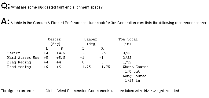

Suspension/Tires/Brakes/Steering section of the 3rd gen FAQ - https://www.thirdgen.org/newdesign/faq/thirdgen.shtml
I tried to make the table but the messageboard messed up the spacing and it looked crazy. I'll try to post a pic of it (screenshot).

Code:
Caster Camber Toe Total
(deg) (deg) (in)
L R L R
Street +4 +4.5 -.5 -.5 3/32
Hard Street Use +5 +5.5 -1 -1 3/32
Drag Racing +4 +4 0 0 1/32
Road racing +6 +6 -1.75 -1.75 Short Course
1/8 out
Long Course
1/16 in
The figures are credited to Global West Suspension Components and are taken with driver weight included there ya go... straight from the sites FAQ..
