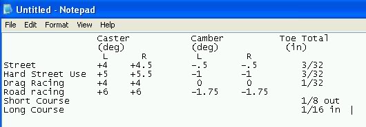

I agree. The camber is completely wrong. The caster is completely wrong. The only thing they adjusted was the Toe In......But they adjusted that the wrong way and to the wrong setting.
Let's start with the camber. You want about -0.5 on both sides. This means the tires lean slightly towards the inside when you're driving straight down the road. The high performance guys aim for -1.0, but that will wear out your inside tire during prolonged highway driving. I would accept -0.3 as decent. Let's throw some numbers for you.
Camber settings
+"any number" = bad. You're wearing out the outside of the tire and getting no performance.
-0.3 = OK
-0.5 = Better
-0.8 = Perfect (Great performance without sacrificing wear)
-1.0 = High performance, but will wear the inside of the tire over time.
You have -5.3 camber on the left and +5.9 camber on the right. I don't see how this is even possible.
Moving on to Caster....... 3.0 is about the minimum I'd ever want to see. 4.0 is about stock. 5.0 is high performance. These should be close to the same on both sides, but with aprox 0.5 more caster on the right hand side. (This keeps the car from drifting into the sidewalk or ditch when you take your hands off the steering wheel). So the caster readings should look something like this.
Left...Right
4.0...4.5 (OK)
4.2...4.7 (Better)
4.8...5.3 (Fantastic)
You get the idea.
If you have the same settings for both sides. Say 4.5 and 4.5, the car will drive straight assuming the road is straight. But most all roads are slightly tilted to the right to allow rain water to run off. Hence the split caster numbers.
You have 0.5 caster on the left and 2.2 caster on the right. That's too much difference between left and right (it's overcompensating) and the numbers are too low on both sides.
Finally the Toe In setting. Your best bet for street driven cars is a Total Toe In of +0.09 (this is the 3/32nd figure below). If you had +0.03 (or 1/32nd), the car would be too darty at highway speeds. Wanting to zig zag over every road imperfection. Tire wear would be worse too. Rear wheel drive cars naturally toe out when driven forwards. Hence why we have Toe In in the first place. The two balance each other out and give you a nice straight driving stance.
Your car had 10/32nds of Total Toe In (+0.33) before. Waaaay too much Total Toe In. They changed it to 2/32nds of Total Toe Out (-0.06) afterwords. Remember that our cars will naturally toe out when driving. So having the car set to Toe out will mean that it's waaaay too much Toe Out when driving. This eats tires in no time at all.
Lastly, forget about the red/green color scheme in the pictures. The colors are simply wrong.
All the above is a bit tricky to figure out. But the picture below will spell it out in easy to understand settings.
