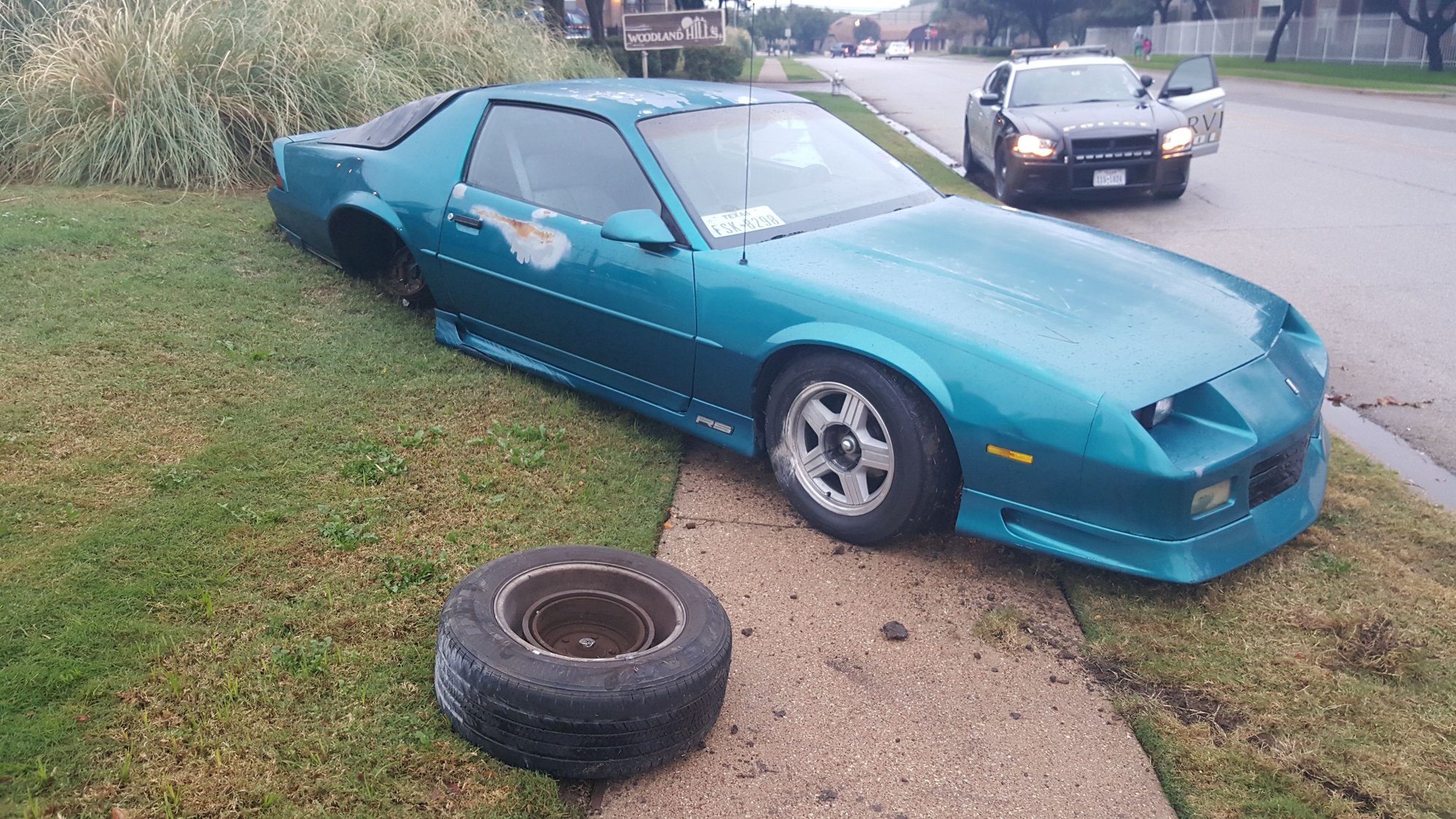

I’m in the process of rebuilding my 92 RS after crashing it 10 years ago. I
swung around in the rain and hit a curb. It broke off the rear right axle and hit the front wheel on the same side. I’ve replaced all of the damaged parts in the rear and now I’ve moved on to the front. I replaced the tie rods and center link, although they weren’t necessarily bent, but I can’t seem to figure out why my steering wheel is so far off-center. When the steering wheel is centered with the gearbox, both wheels are pointed a good amount to the left and if the wheels are straight, the steering wheel and a half a rotation to the right. Before making this post, I adjusted the p/s strut mount a bit and I removed the a-arm hoping the bushings were destroyed and they weren’t. I also don’t see any clear indications, like dirt lines, that the k-member shifted. What else could it be? Could it be something further up like in the gearbox or steering shaft? I don’t want to keep buying random parts if they’re not needed because those will start adding up. I thought about the k-member shifting to the left or the frame being tweaked, but based on how the tie rods are setup, if everything got shifted back to the right, that would push my wheels more to the left. ANY help that you guys can give me at this point would be helpful
