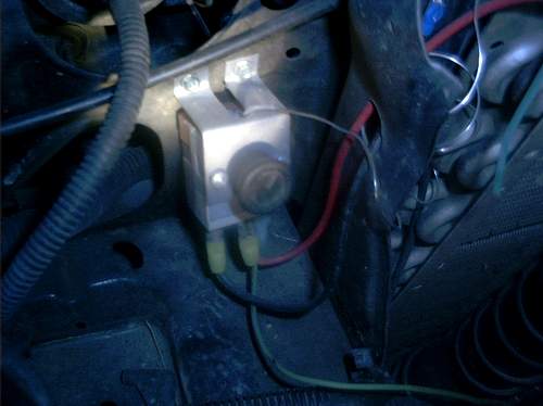

hey bro..hopes this helps....my car breaks down like this...driver fan is controlled by the computer chip...passenger fan is controlled by thermal switch in right hand cylinder head...my car overheated as well..learning that the fans would not come on until some *** awful temp set from the factory...i replaced the chip with one from hyper tech....and a cooler fan switch from hyper tech...along with a 160 deg stat...only reason i run one that cool is because that is what the new chip calls for...had system flushed and wow..no overheating..gotta love it...hope that helps bro..later

I love my set up alot. I just go by my gauge and set my fan to turn on a certian tempature. I have it set on 200* and my car runs 160 on the highway and in traffic is usually around 195ish.

OK....I've ordered a Hypertech cool fan switch from thunderracing.com. Comes on at 200 and off at 180. It should take care of the prob. The car will not get above 237 as it is. I watch the guage closely. And 237 is the factory set temp for the fans to turn on (they like em to run hot for emissions). So, It appears that everything is operating as it should, even though it runs at higher temps than I might like. So, by replacing the switch, I should be in an acceptable operating temp range (fingers crossed).
