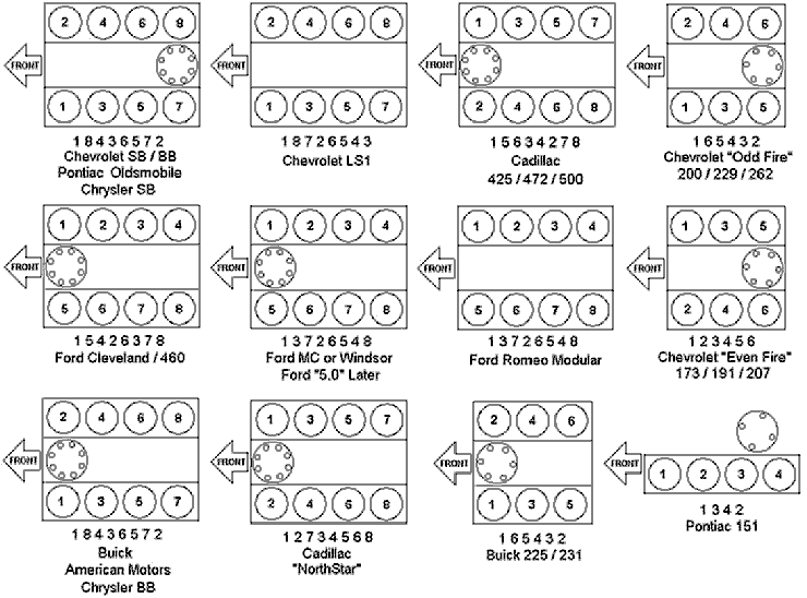

New: P/U coil, Newplugs,new coil,new ignition modual, wires in proper order......Hey, Change the cap and rotor......it may have a hairline crack you cant see. While your at it change the rotor, May as well eliminate All the ignition parts. (As Morley Said)
I think I would be a little more thorough,about specs...gap the plugs, factory settings are not accurate...check the the timing with a light all this messing around the dist. may have moved something. Make sure the clamp is tight. Check for any freyed or bare wires leading to the dist..
If none of this helps, I too am stumped. I bet it is something really simple, usually is...just to be sure

Check wires 5 and 7 very closely. Since they are adjacent to each other both physically and in the firing order, it's an easy mistake to make. I've done it myself more times than I'd care to admit.
What kind of coil did you use? Some coils don't match the OEM HEI module correctly.
