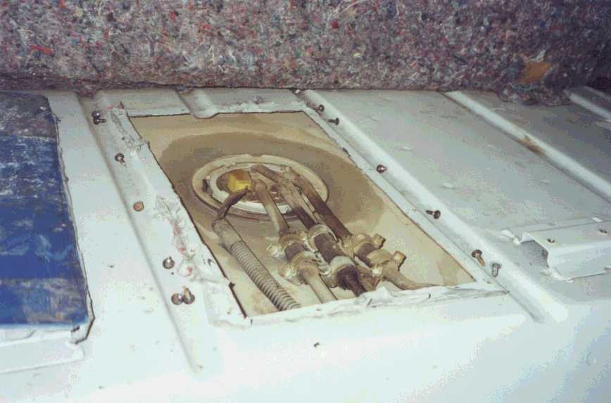

im not going to drop the tank, the hole is already there, and i dont have the time or the place to do it. Im just trying to get some opinions on what will be the safest method of reconnecting the fuel lines.
heres a pic of someone elses just so u have a better idea of what im talking about, they used rubber hose and clamps.
AN unions and flare the lines, also use tube sleeves to reinforce the flares. If its good enough for 3000 PSI hydraulic systems then I think a 50 PSI fuel system will be ok.
