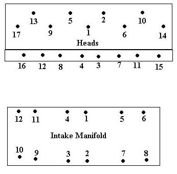

I have a blown head gasket. I am about to start but before I do I need to know torque specs and torque sequence for the heads and intake. Any other things I need to know? Any info would be appreciated.

This is off the top of my head..... but I'm 99.9% sure it's right.
It's really pretty easy, just start in the center and rotate clockwise.
Go in 3 step 15lb increments for the heads, and 2 step 15 lb increments for the intake.
I.E. Heads..... 35/50/65
Intake 20/35

Intake manifold is 30, at least that's what I thought.
