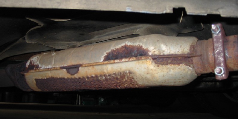

I have an '83 Z28 with an LG4 and I have this cat. This is a honeycomb cat correct? I think '82s had the pellet type.

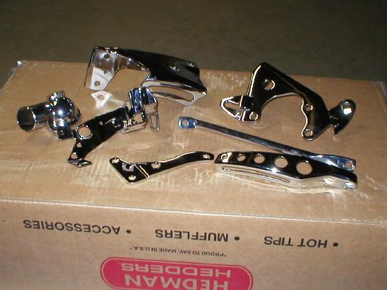

hey Confuzed...need some more chrome to go with that alt.bracket

Yep, I'm a big spender on chrome..... Got my ALT bracket straight from JC Whitney! lol And got the valve covers free!! .
Did those brackets come in one kit??

The A/C bracket, A/C support rod, throttle bracket and power steering bracket I had chromed...The others are Mr. Gasket
