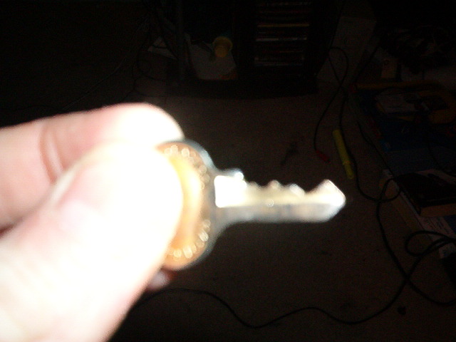

d00d that is the key i ude to start the car. I mean d00d, can't you see how there are vitually no notches to make it original. I mean i have VATS, so does that mean that the keys are the same but vats is just usedto make sure its the right key or something? And you can't just get the key copied at walmart or something it has to have the propper resistance of the orginal key. If not the key is useless
check the attachment, that is a lock key and it has many notches, my car key has one.

this might help

oooh you mean how your unique key only has one "valley" in it?
look at this:
http://home.howstuffworks.com/question710.htm
you key uses several tumblers, not just one, even though it appears that way...
and btw, if you start your car with that key, you either have vats bypassed, or you dont have vats... there is no chip on that key.

Car: 1986 Trans Am
Engine: 305 LB9 TPI
Transmission: 700-R4
your telling me that 1986 trans ams didn't come with VATS?
no... im just saying if your car can start with that key, your car doesnt have it working.
someone could have bypassed it with a resistor, or somthing....
but that is not a vats key.
as to if it came stock with vats or not, i donno... i never bothered to look up when vats came out with what cars...

Actually, I don't think it did. I believe they started them in f-bodies in 89.

If you start it with that key in the pic, VATS is not working or not there at all (my guess it's not there) The VATS key has a black plastic bit near the big end and that key doesn't.

No, he's not, but I am. Only the Corvettes had VATS in 1986. That's a normal ignition cylinder key.
BTW - MrDude_1 is very optomistic. Our lock cylinders don't use pin followers, but cheaper plates instead. That's why they wear out so quickly. That photo looks like a Seargent lock, SFIC slide. I prefer Schlage...
