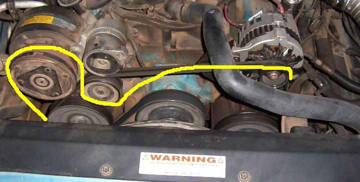

Here's my engine now. Dirty, I know. But is the belt on the tentioner? I'm going tomorrow to get a new belt. Would I just look for one for an AC delete car?

Well i would say the problem is, the belt isnt tight enough, the tensioner looks like its almost bottomed out, here is a pic of how it should be routed with a stock belt.
edit: I just read your AC compressor is seized, either find a ac compressor at the yard, or get a ac delete pulley.

see the pulley with the spring on it (the tensioner pully) that pully should be at about 3 o'clock not 6 o'clock there for the belt is not tight.... thats a bad thing too cuz the water pump isn't getting the full power it needs.

The main reason you are getting that noise, is in fact your belt is worn, but that is due to the fact that the belt is riding the wrong side of the tensioner pulley. This will wear the belt down very quickly. Go to your local wreckers and find a A/C delete pulley, and buy a new belt, and do it right.
No you cannot adjust the tesioner pulley, that is how it works...it is a spring loaded tensioner. So it forces against the belts to keep it tight. By just replacing the belt, and leaving it the way it is, you will have the same problem in no time.

just get the damn AC delete kit. its like $20 i think if you can find one at the bone yard you really need to get that fixed.... see in the pic where its rubbing on the top of the belt.... your goign to end up snapping that belt at high RMP's :-D

Actually that wear mark on the top of the belt is just from the tensioner pulley as the pulley is in fact to pieces pressed together . But either or... get the AC delete pulley and do it right the first time to avoid being stranded in the middle of no where.

tamatt27 Ive colored in red on your pic the routing I use. it is the same size belt you have now, and the tensioner will still be aligned where it would be if the factory routing was used . the only time I get any belt squeel is if I rev the engine to around 4500rpm very quickly in park only. even then its just a quick half second chirp out of it.
