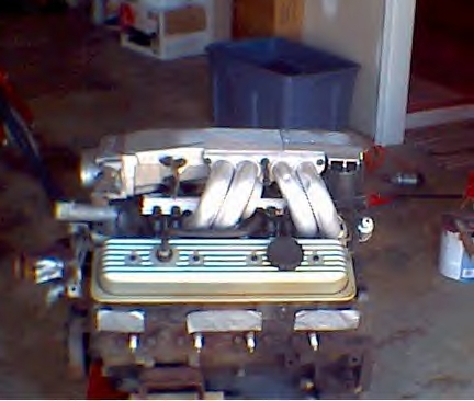

Originally posted by 89RsPower!
look at the little ledge near the top corner of the water pump in front of the pass side head.. has a partial vin # from the vehicle its from and a suffix code.. see if the vin matches
Well, I can't b/c we have already got rid of the car
But here is a pic of the motor:
