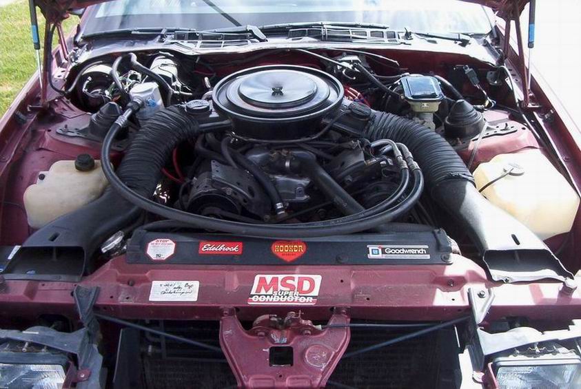

To do an "el-cheapo" but usefull mod, go to the junkyard and find an aircleaner lid that is the same diameter as the K&N filter. That should be about 12" or 14", measure to be sure. They'll charge you a buck or two.
Then replace the original lid. This will give you a lot more air than that factory pea-shooter.
The best replacement is a dual snorkle outfit from one of the 305 HO engines they made for the 3rd gen Camaros and Firebirds. They are now quite rare but look around. They are worth 1/4 of a second in the quarter mile on a 305 3rd gen! And be sure to get the entire assembly, including the ducts and flexible hosing. Those parts are not being made or sold by anyone any longer and they are even harder than the cleaner assembly to find
Here's a pic of what you want.
