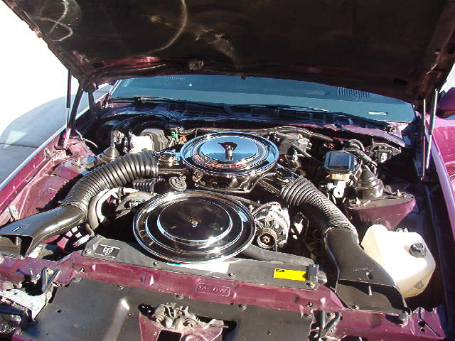

I agree with Adam, they are getting pricey. I bid $185.00 on e-bay just for the driver's side plastic scoop AND LOST!!!!! I eventually just bought another whole set up.
If you can get an entire set up for a good price do it. If you do it piece by piece, they will be hard to track down. Since they are not made any more.
Here is my set up.
