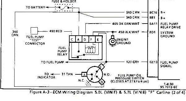

Okay... So if your TPI engine all of a sudden loses all oil pressure what happens? Are you saying that the ECM is driving the fuel pump relay all this time and the engine continues to get fuel and spins itself dry?
I say the oil pressure switch goes open (due to loss of oil pressure) and the fuel pump stops running.
Similarly, if you go around a high-G corner and starve the oil pump pickup of oil momentarily, the fuel pump will not see power for a moment or two - enough to cause the engine to stumble.
AARON7 - do us a favour and pull the connector off the oil pressure switch while the car is idling and tell us what happens...

8Mike9, Stekman...
This is my last post on this topic as I don't want to hijack a legitmate thread arguing about the oil pressure switch.
Got a Haynes manual close by? Turn to page 10-22 and you can see that all current to the in-tank electric pump goes through the oil pressure switch! This applies to 1990 and later V8 TPI models. So... no oil pressure, no fuel pump current - simple as that.
If you look at page 10-21 ('89 and earlier models) you will note that any current from the fuel pump relay goes through the oil pressure switch to the electric fuel pump. There is a connection from the ECM to the fuel pump to prime the fuel rails. Apparently in later models they skipped the priming, since cranking speed should muster up the relatively low oil pressure required to close the oil pressure switch and provide fuel.
Don't believe me? Try unplugging the oil pressure switch and drive around the block.

Please see attached image. This pic is from the '91 GM Helm service manual. The fuel pump relay and the oil pressure switch are in parallel. Either one will enable the fuel pump. Neither one can disable the fuel pump on it's own.
The ECM will enable the fuel pump relay as long as it receives distributor reference pulses. The oil pressure switch will enable the fuel pump as long as the oil pressure is above 4 psi.
