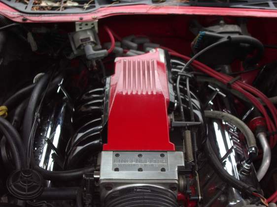

Also I have plenty of pictures of the car. Couple of the motor, would one of you be willing to check them out and tell me if its an LT1? I know the intake and all of that looks similar to what is on my 87 305 seems like it sits a bit higher. I`d appreciate it if you would/could.

Yup, post em. Those motors are pretty easy to tell apart.

Heres one.
Attached Thumbnails Lingenfelter LT1-c-documents-settings-brad

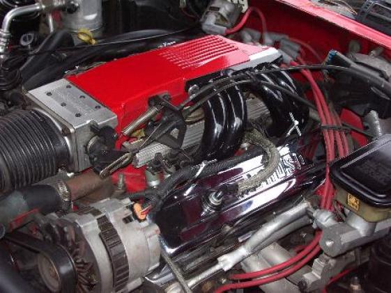

Pic 2

Not a LT1.
That's a TPI motor, with the runners painted black and the plenum painted red.
Lie #1 exposed.
OK, so now you know the guy is a liar. What other sunshine has he pumped your lower orifice full of?

Is it possible that it is the lingenfelter block with a TPI set up? He`s been very straight forward about it all. Claims car has 95k did check on all of that and is clean. Its a 5 speed conversion, 3 inch exhaust, 17" wheels, needs interior work and the clear coat is peeling/fading whatever you want to call it. He`s asking 6200. Thats initially why I was skeptical because Lingenfelter charges 9100 for the motor. Would it be a worthwhile investment once I see track slips?

I'd be willing to bet it's a little of A and B. That TPI setup looks clean, but aesthetic's dont get 11 time slips.
If you really want to see if this guy has the motor that he's claiming.. when you go down there tell him that you will buy it under the condition that he, or you, runs it at the track and it gets atleast into the 12's to proove that it's what he says it is.

I don't know... sounds to me like nothing the guy says is for real.
Yes it is possible that some portion of the engine (besides just the throttle body cover plate) came from Lingenfelter. Not likely if they have no record, I would have to say though.
If it was me, I'd have to see it all in writing, from a reputable source; dyno printout, track slips, receipts, etc. Otherwise, it's just an old car, that somebody stuck some earlier-model (or otherwise non-centerbolt valve cover) heads, some chrome valve covers, and Edlebrock TES onto; and did the usual "impress the viewer when I pop the hood without actually accomplishing anything" thing of painting all the TPI parts.
Without proof, I don't see how painting the runners and plenum and slapping a set of chrome valve covers on it, makes that car worth $2500 more than another one just like it with stock finished runners and plenum and stock VCs.
I think he's fishing for a sucker, to try to get top dollar for his car. Too bad he's lying in order to hook somebody that's not well enough informed to protect him/herself.

Even if it was an LT1, which it isn't.
There's nothing about that engine that's LT1, because it's nearly impossible to mount a TPI on top of an LT1 block.
